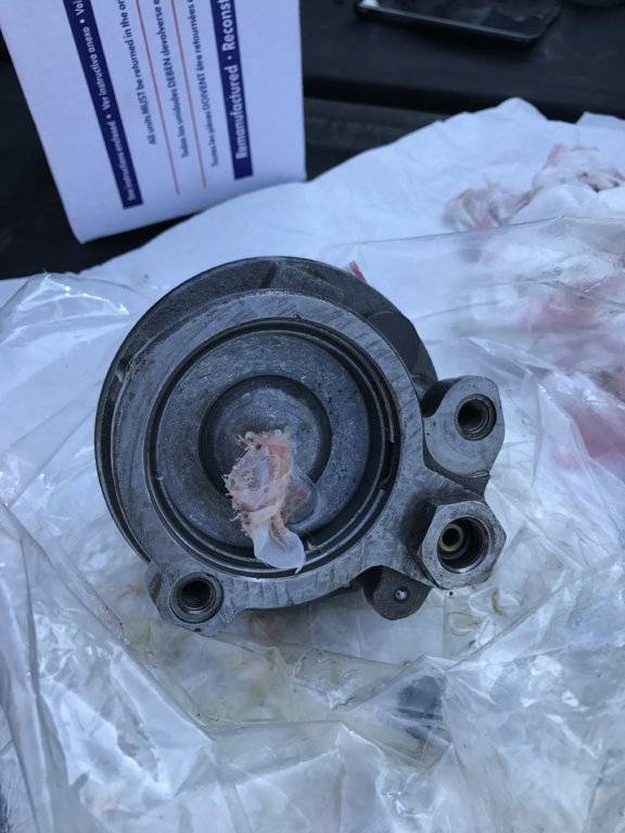

Ok, public service announcement time:
Last summer we were on a ten day Mopar only tour when a friend of mine kept having his power steering going in and out. (The motor was a fresh build and he used a new pump from either Year One or Classic Ind.) Eventually, the power assist part gave up all together and we spent that night tearing things apart in the hotel parking lot. Not finding anything obvious (blocked screens, kinked hoses etc.) he ordered a reman pump from the local auto parts store before they closed for the evening, which would have it in the morning.
Next morning he picks up the pump and proceeds to switch the reservoir over as the new pump didn't come with one. Upon pulling it apart he finds a little magnet the manufacturer installed to help catch any metal shavings that might be present in the fluid. Good idea, right ?
Well, it would have been had they taken the magnet out of the little plastic bag it came in before chucking it into the reservoir. The little bugger got stuck in the inlet of the pump, plugging up the works.
So the moral or the story is : If you get a replacement pump with the reservoir attached, you might want to crack it open and have a look before installing it.

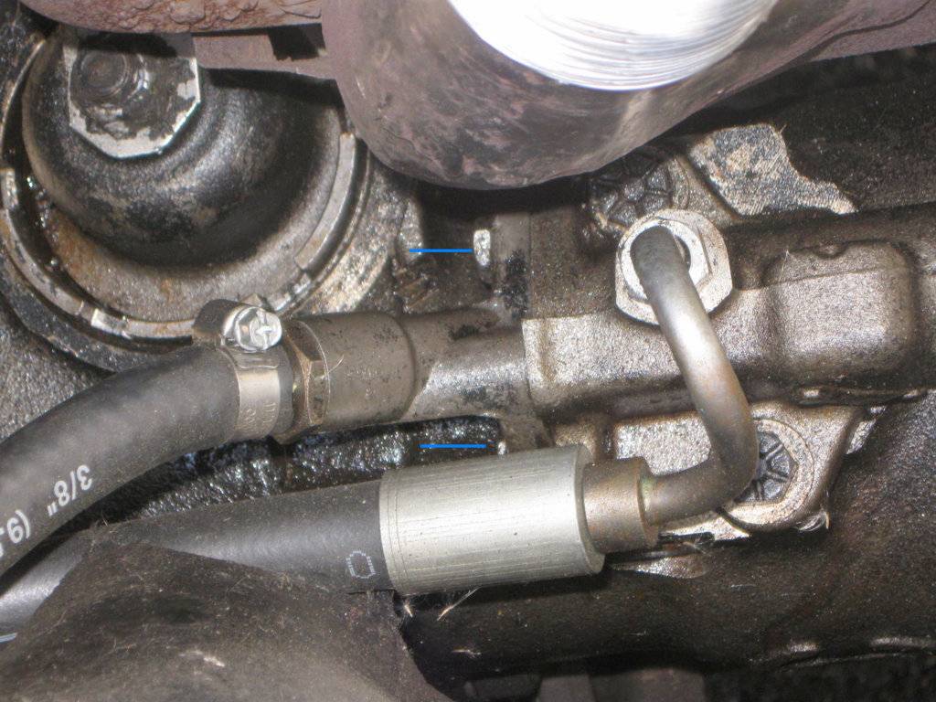

Under the hose mount, in my picture, and you remove the two bolts that hold it down guess what you find? O-rings. Mine leaked and I tightened the two bolts with the blue dash and the leak didn't stop. When I looked under and saw the o-rings I replaced them and not a drop has leaked anywhere since 2010. Of course couldn't get a few o-rings but ended up with a large bag of them.
