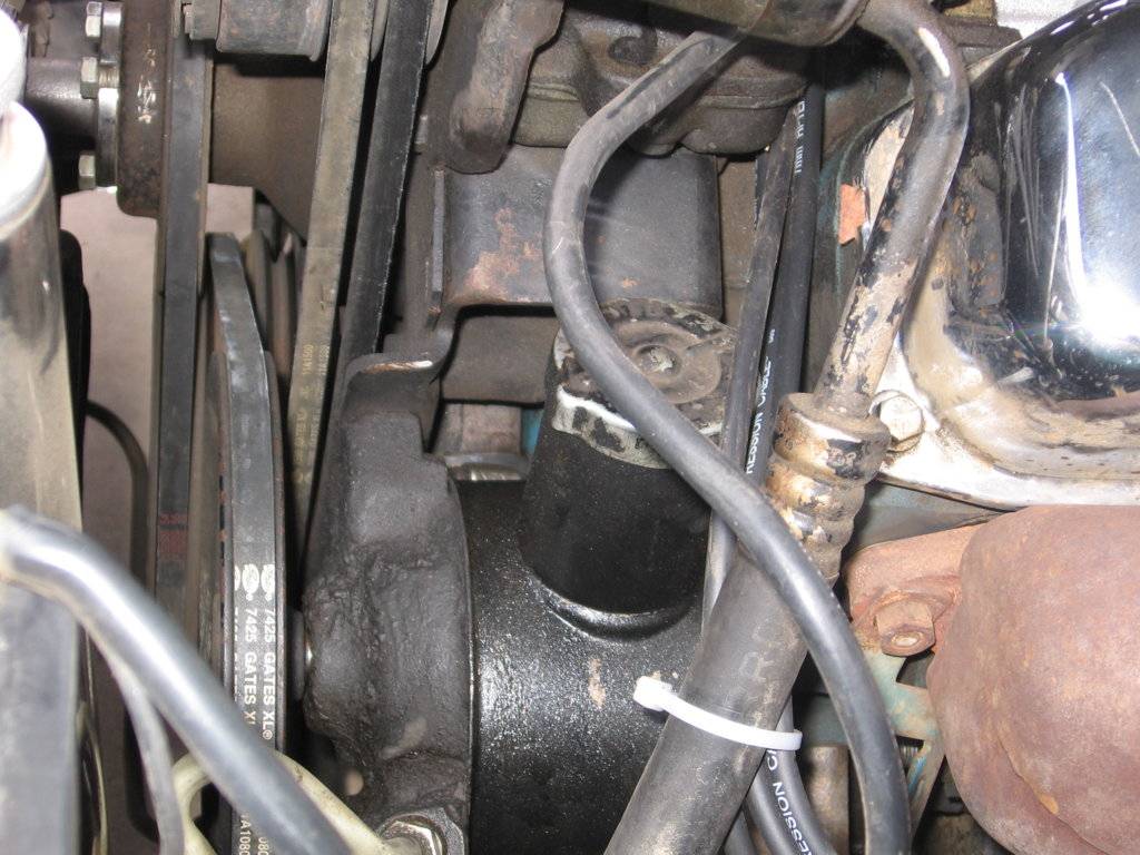

Hey friends. I want to replace my power steering pump. Problem is, of the three that are available through Rockauto.com, which do I have?
Can you tell me from the picture?
Thanks
That pump does not look like it is leaking, why are you going to replace it? If it is making a lot of noise, try flushing out the old fluid and replace it with fresh power steering fluid. A lot of these pumps were noisy from aeration due to incorrect/contaminated fluid foaming in the pump.
Dave
By the looks of the cap, I think that's the federal. And as I recall, the federal's have a larger pulley, around 7 inches? Versus Saginaw's 5 inch? Either will work with a belt change.- edit- when I did it l had a whole used known good one from a parts car I drove, the brackets are likely different.
I would just reseal it, most ''rebuilds'' are just cleaned and resealed. You then can paint, detail the pump if you like.
Federal Pump, you can easily tell by the mount bracket.
The earlier TRW pumps looked similar, but had different mount brackets.
And the Saginaw is completely different altogether.
For those that have asked, and I figured some of you would, it leaks and grinds. I have already rebuilt it once, new seals and all. Now, unless it is filled to half the tube, it grinds and whines. It's rather embarrassing to drive at such times. I have to top it off every other month.

If it's leakin around the housing where the big O-ring is, the only way I could get mine to stop was to put a big hose clamp up front to stop it. But you have noise as well, so yeah, replace it. Good Luck
I sealed mine with a new o-ring and some Mopar atf sealant. That stuff is killer.

Even so, I found my leaking problem to be the two hoses. I've ordered the pressure hose from Rockauto.
