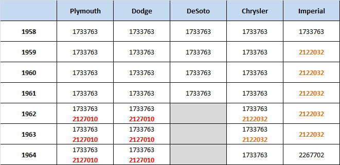

    So I did a little research using parts books and interchange manuals, to check what Davea Lux said.
    The power steering box that came with my '58 has the casting number 1733596. The one I have bought remanufactured has the casting number 2127061 or maybe 2121061 (difficult to tell from under the car). Being casting numbers, it's not possible to find an exact application, but we can assume that the casting numbers are close to the parts numbers used in the year of their application. It's an assumption, but that's all we have.
    If we look at the part number of the power steering assembly (chuck) over the years (chart below), we see that the power steering I had with the car was probably correct for a '58 application, and we see 2 different applications that might fit the remanufactured one : '59-'64 Imperial, or '62-'64 Plymouth/Dodge, the latter being the closest one in part number to the casting number. I'll assume it's that one.
    The interchange manual is of course confirming this, as it lists two separate interchange possibilities : '58-'61 Plymouth and '62-'64 Plymouth.
    However, it's different groups for the power steering pumps : '58-early '60, then late '60-'64.
    Moving on to the service manuals, the '58 Plymouth one list the maximum pressure of the power steering pump at 750-900 psi.
    And that's were I'm stuck. I have not found a '62-'64 Plymouth/Dodge service manual, so I cannot check what's the pump pressure for the latter power steering. I was able to look at a '63 Chrysler/Imperial service manual, and found that the pump pressure was 1150-1300 psi for the 2122032 power steering. Which might be close to the specifications on the 2127010. Or not.
    If someone here has access to a '62-'64 Plymouth/Dodge service manual, please let me know.
    Thanks.
