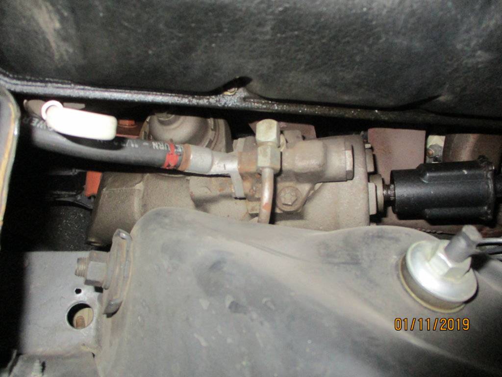

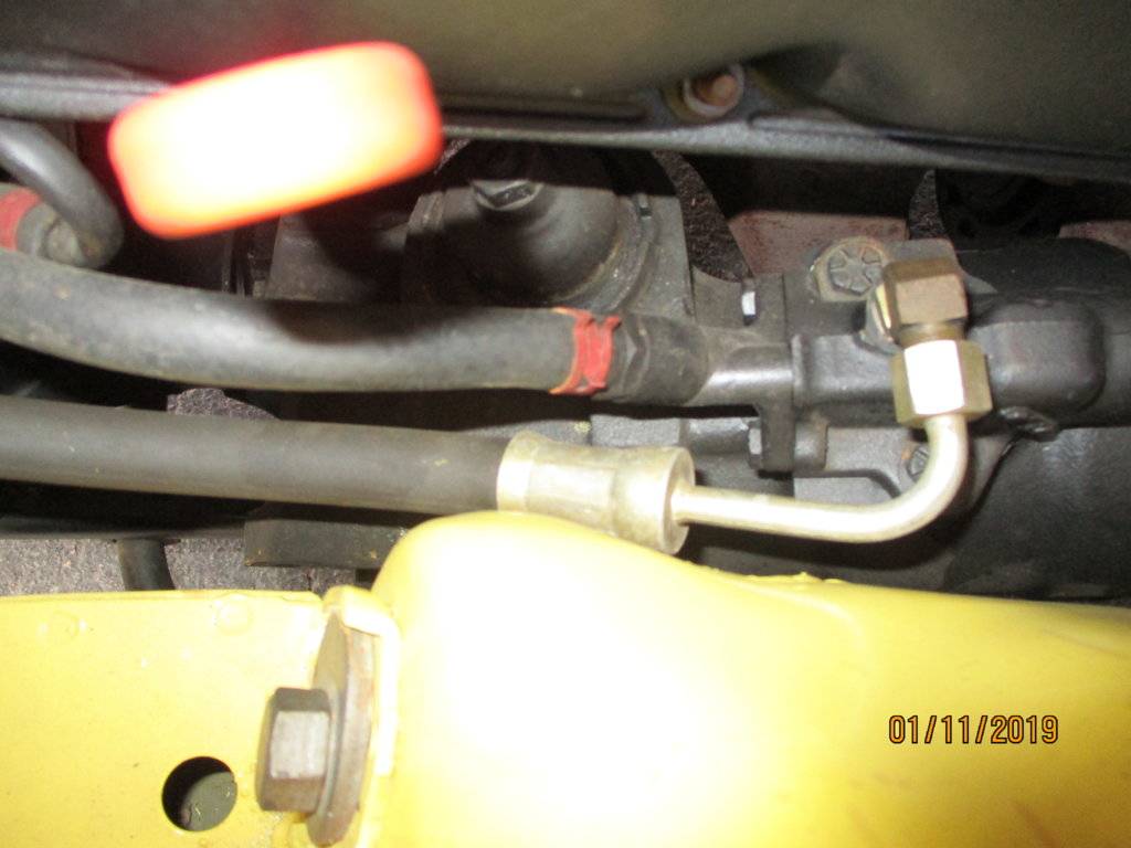

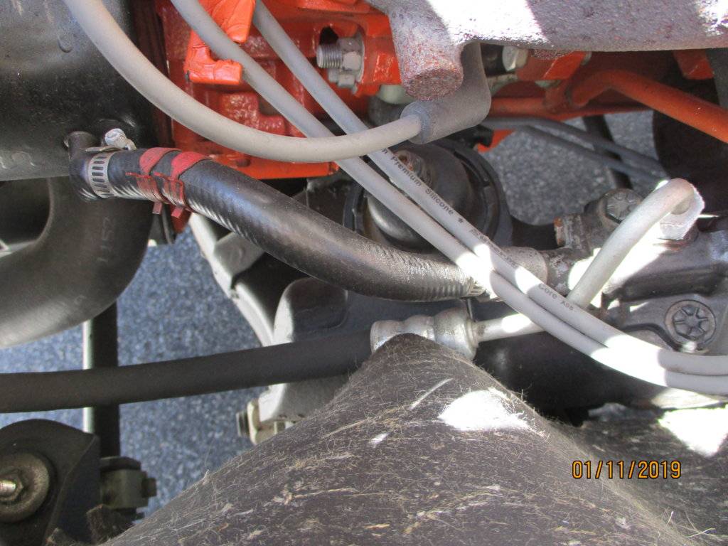

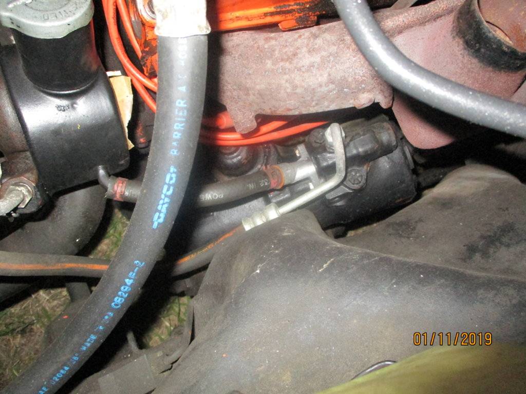

I did my 62 880 as the pump reservoir was leaking and since I had it out I replaced both hoses, napa has them in stock, return is cut to fit.

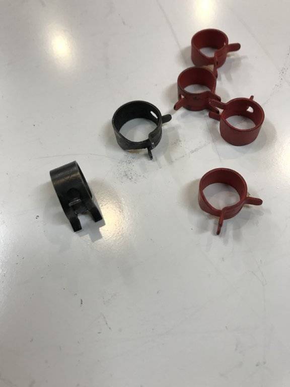

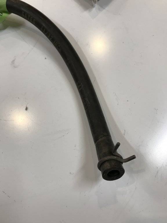

I did a search and found this old thread. All the hose choices are covered, but what about the clamps? What is the proper style used on these? Mine had the worm gear type which I don’t believe are correct. Any help on the correct type?
My assumption is something like this. (On my brake booster line which is original) or were they more like the fuel line clamps?
Like your first picture. They are called corbin clamps. Used on all the hoses except the fuel line. The fuel line is a crimp clamp.
