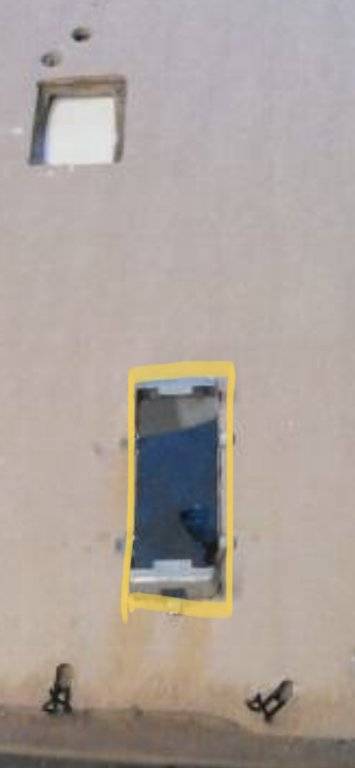

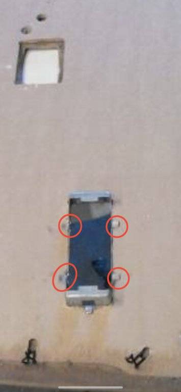

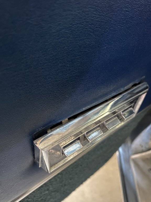

Does anyone happen to have any pictures of the back side of these switches and how they connect to the panel?
My 68 300 power switches all kind of ‘droop out’ of the panels. It looks like the tabs that hold them in place have blown out the chip board in the panel. I was going to come on here and ask if there is some kind of retainer plate for the back of the panels then I found this thread. Sounds like some type of bracket/plate is standard for these switches, but may be missing on my doors. I am interested in learning more.
Thanks!
Some photos of my drooping switches:
Thanks!
I was hesitant to post a pic of my '70 (different switches) but after looking at @D Cluley 's eBay link, the retainers look similar enough that it should give you a good idea how they mount.
Thanks for the additional information. I am pretty sure those bezels are still on my switches…. After seeing Big John’s photo of the backside of the panel I am almost certain the little metal tabs were ‘pulled through’ the chip board (or whatever that material is) on the panel.
I’ll have to pull the panels off to be sure, but I am thinking I could reinforce the back of the opening in some way? Maybe a thin metal frame/bracket that those tabs could hang on to??
