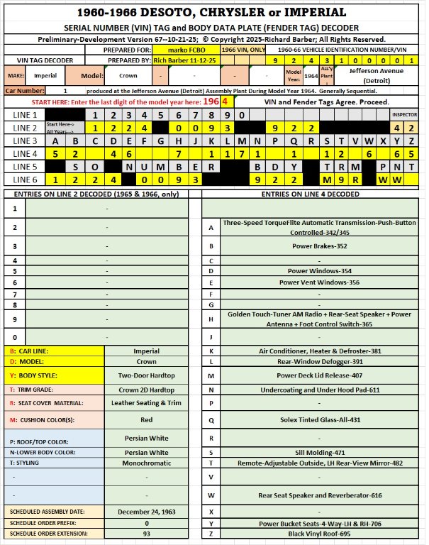

anyone have a source for pre 1965 option codes ?
im looking for the 2 digit alpha numeric option codes used on imperial body tags.
alpha above, numeric below
it might help if i could find a dealer order form or could see a broadcast sheet, preferably 1964 so i can see how they correspond to the 3 digit codes used on other mopars.
