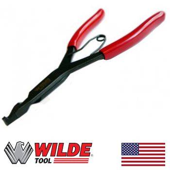

As stated mark your intermediate shaft (gear position). I use lock ring pliers like the one shown to remove. Also mark your distributor to block position so as not to disturb timing. Last make sure your rotor position is the same so as not to get 180 degrees out. Some quick pics can help you remember.

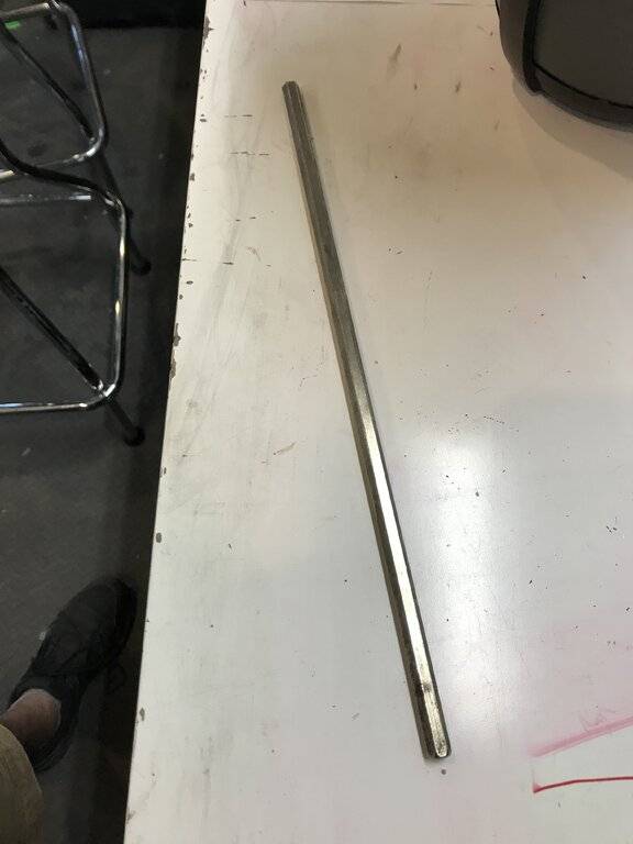

I cut off a 12” chunk of my dry wall/ plaster mixer shaft. It had a 1/4 hex shaft that fit perfectly. Put it in my cordless drill made sure it was going counter clockwise and spun it up until I had pressure. I put a cheap mechanical gauge in while I was spinning it up to monitor and see how much pressure was building.
