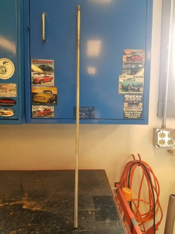

  8. MEV

  9. Lefty71
    Lefty71 Active Member
    Messages:
    216
    Likes Received:
    81
    Joined:
    Mar 17, 2018
    Location:
    Ohio
    Lubriplate is handy for many uses. I didnt realize it was still around tho. THX!
