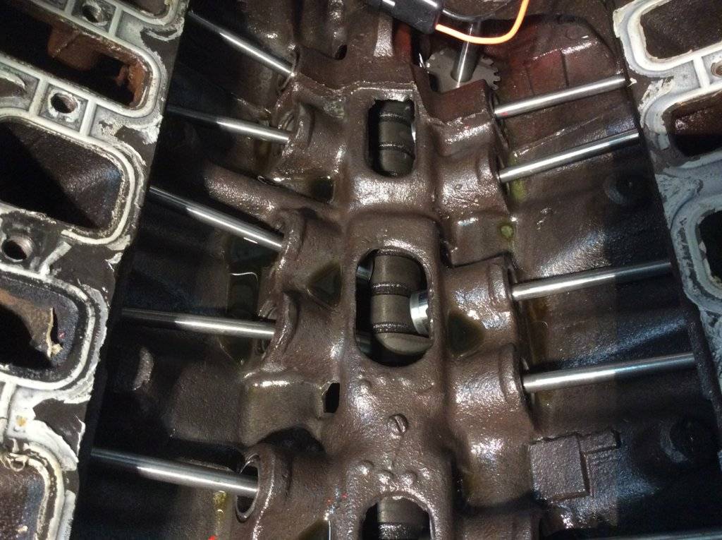

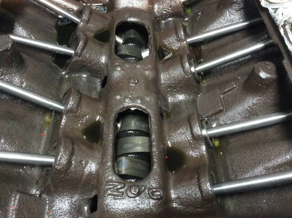

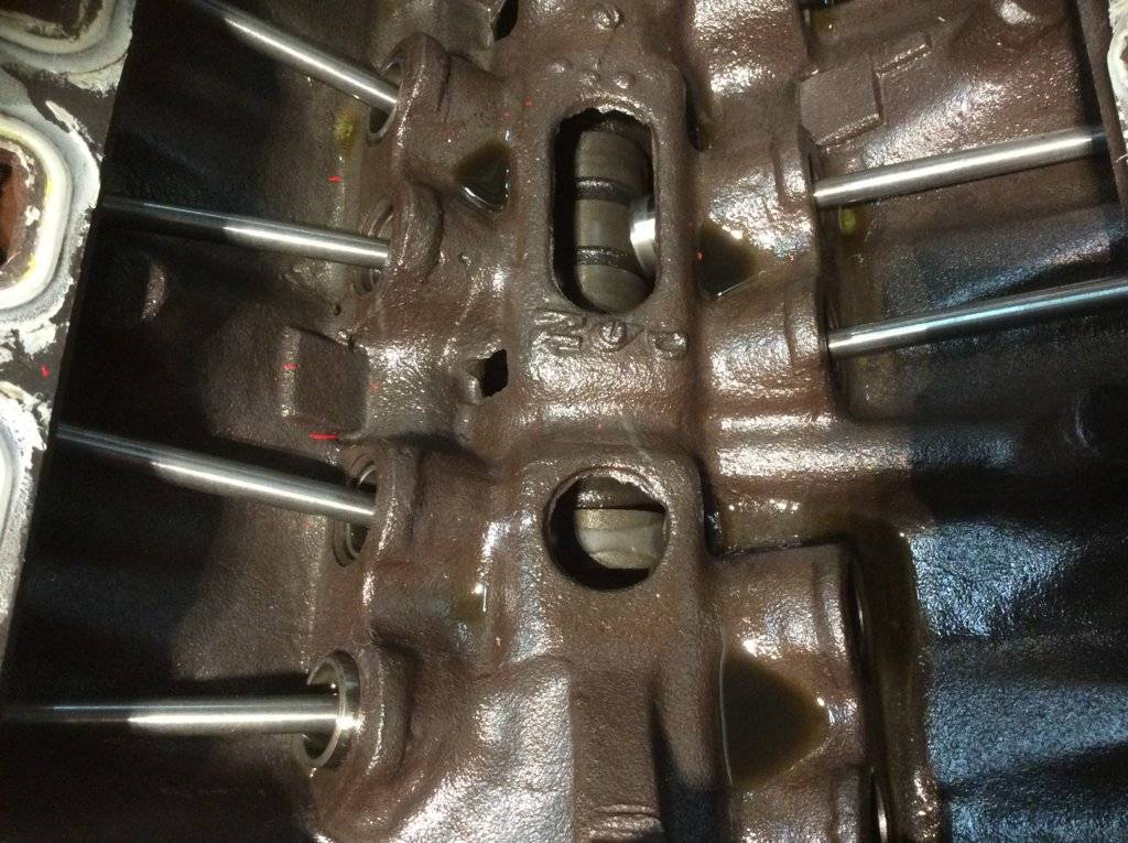

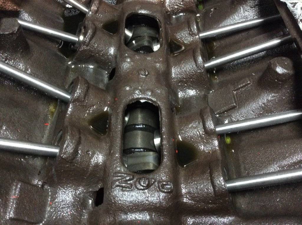

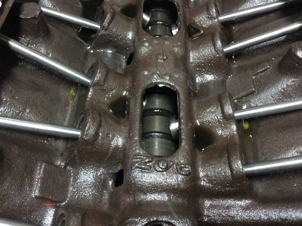

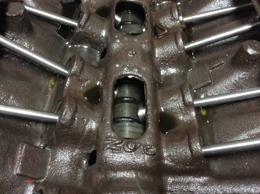

    Here are the cam lobes for cylinder 3&4 through a full rotation.
    Noise was always there, but lately worse. Hence why I intake to inspect when I couldn’t adjust. Is it possible to order push rods that are too short?
    The builder did say he had them set right when he built it. I may have even asked if he could have had the wrong parts. TI he tappets look new as do the pushrods. Not visible wear patterns.

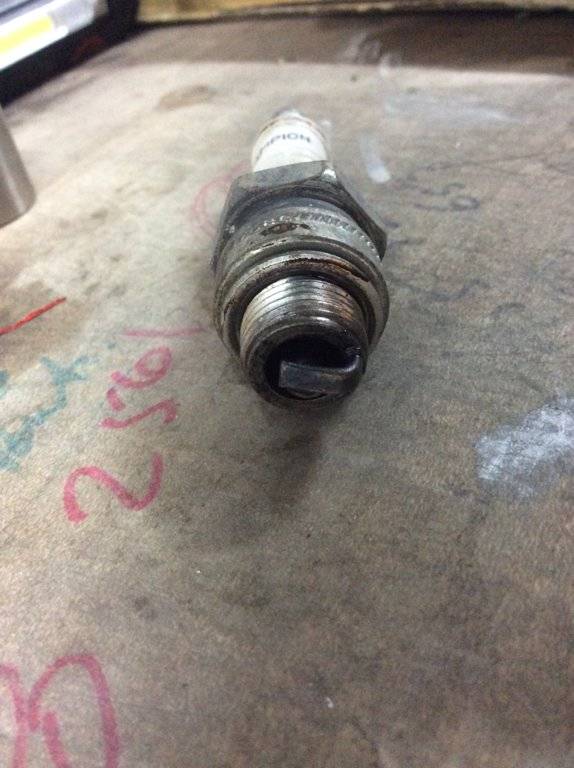

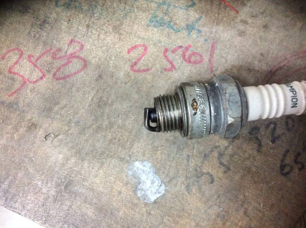

    I did pull the spark plugs and found the spark plug in #8 crushed. I put another one in and cranked by hand and it was not struck. I’m not sure if I put the. In or the builder did, but I would not have put in a bent one.

    Cam is not flat and appears to be breaking in normally. Plug looks like somebody dropped it as it does not show damage from foreign object contact. Push rods are new and most likely the wrong ones. Start there. If you have one of the old ones, check the length against the new ones. Push rods look way short as they should be more or less centered on the lifter.
