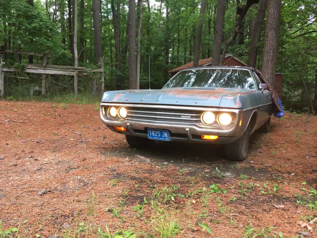

By this time it is March, and I give Delmae her first bath in 26 years, getting that beautiful GA4 Light Gunmetal Metallic to shine (and not blow it all off with the garden hose). It was also at this time that I discovered that the many times it had been sitting on blocks while working on it throughout 2018 had caused the subframe to crush in. Luckily through this wonderful site, I found one @mindshark13 had from a 1971 Newport in Tampa, and was able to get it purchased and shipped by a friend of mine for $250 total, in which it arrived in April. After that, there wasn't too much left to do. A radiator cap fixed an overheating problem and I also managed to find the original license plates to the car sitting in one of the shed.

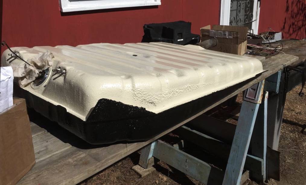

Delmae's original tank. Patched with JB Weld, and two-tone painted in Rustoleum.

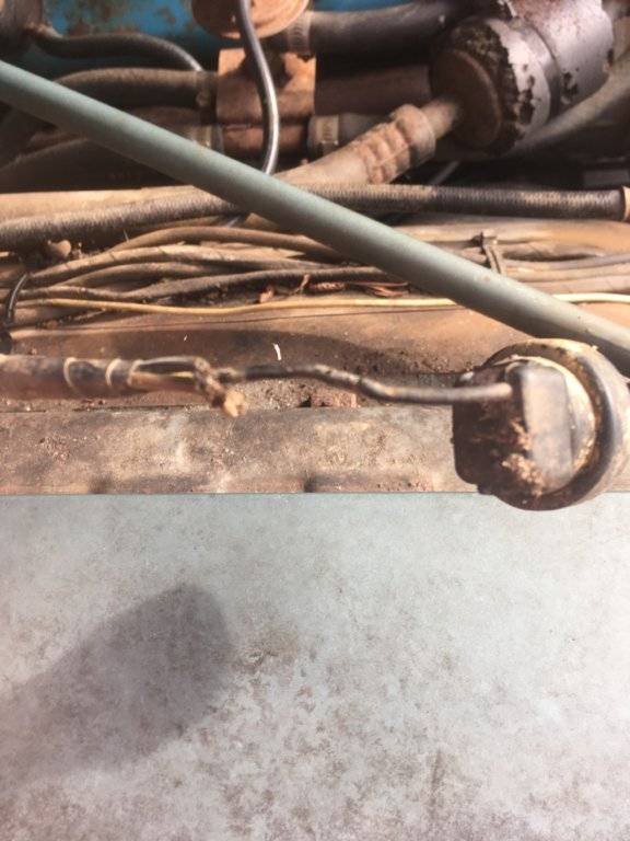

One of the only pieces of wiring the mice had affected. They left just enough in the plug to put a splice in.

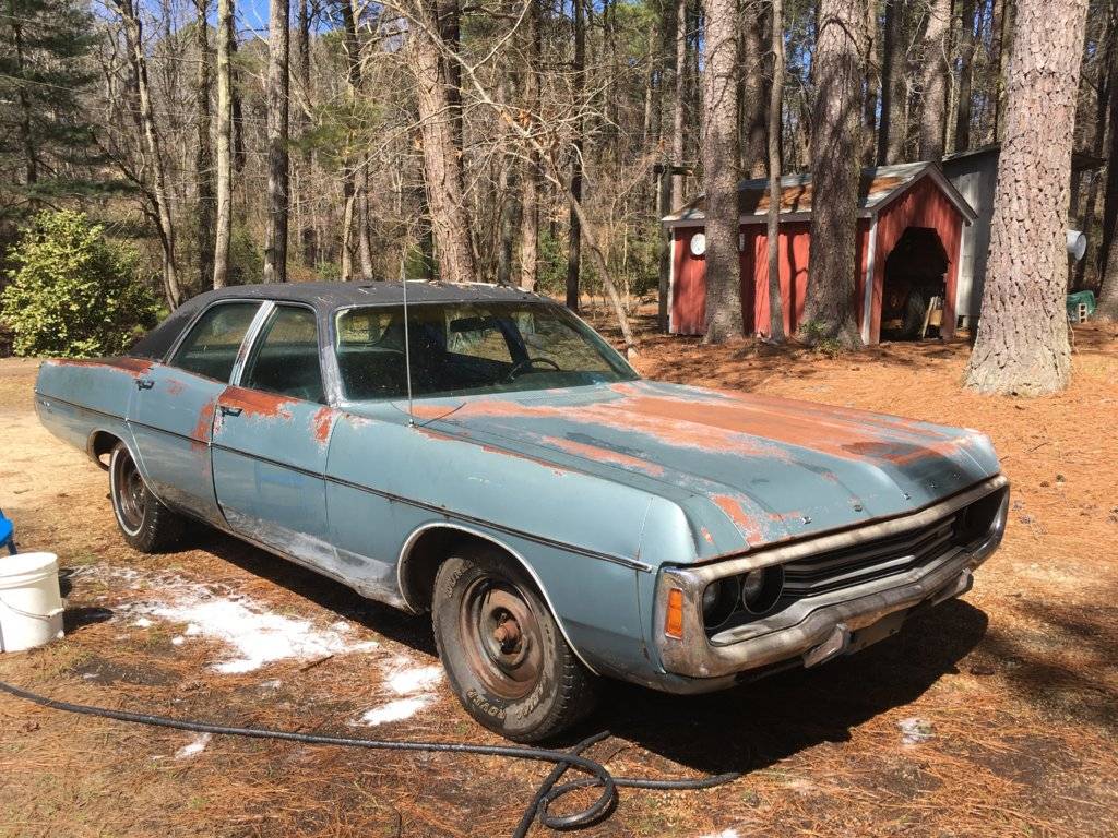

The first time the GA4 Light Gunmetal Grey has really shined. Also...HOSE!

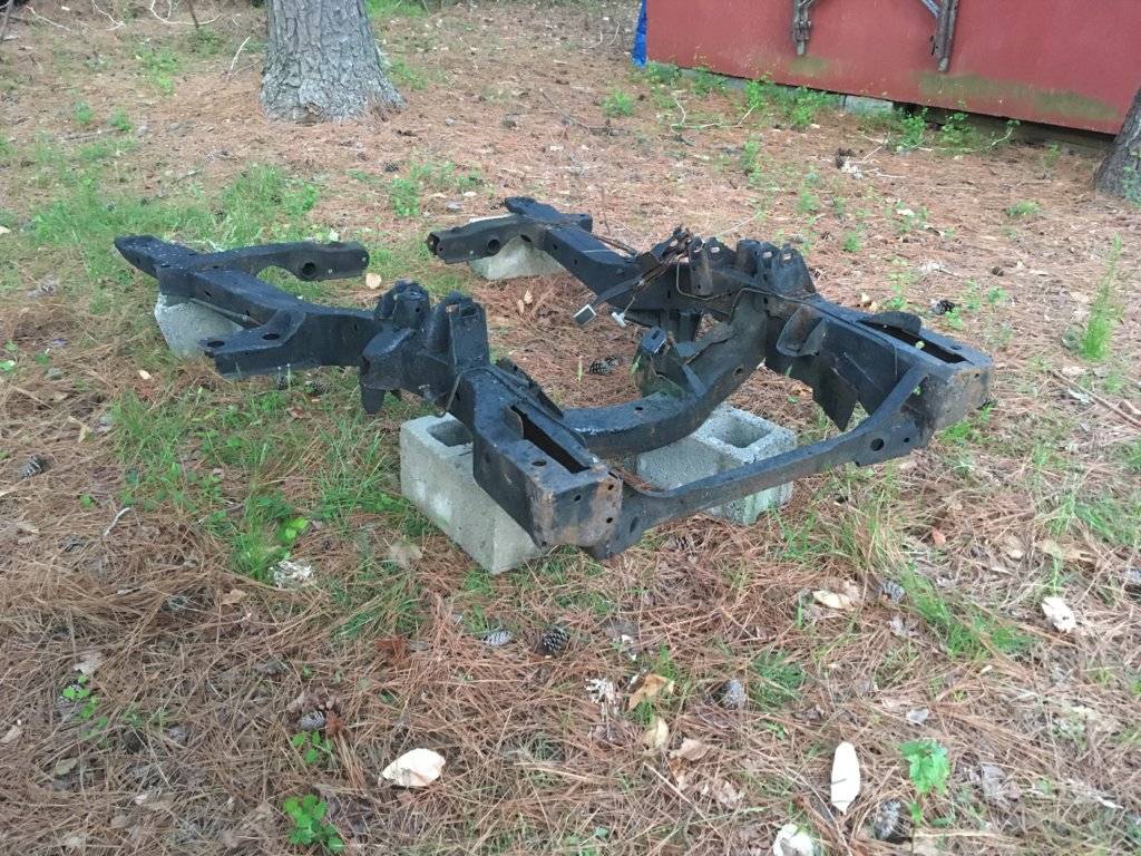

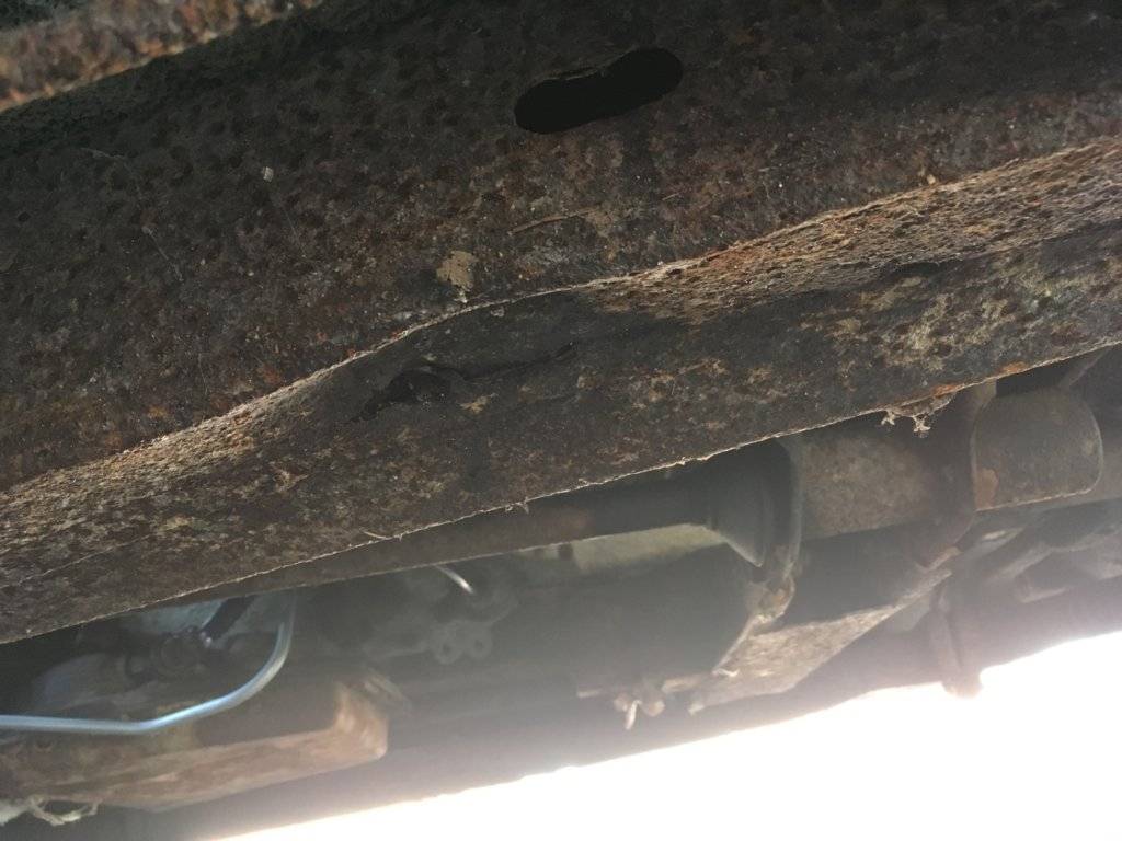

Doesn't look like much, but that is a bit unnerving. Both side are like this, and led me to search for a subframe.
Surprisingly only took about a month to find one and get it. I originally was going to have a guy ship it to me while on a cross country trip delivering Dodge truck parts, but a day after he was supposed to pick up a Macho Rollbar for my truck, everything turned sour and the guy left a whole trailer full of parts in a parking lot in Ohio. Luckily none of my stuff was on it (rollbar was worse than initially told, long long story) and I scrambled to find another shipper. A friend of mine that I went to school with (also a distant cousin) said he was delivering a tractor to Florida and could pick it up for the cost of a tank of diesel. So for $100 I had it delivered.

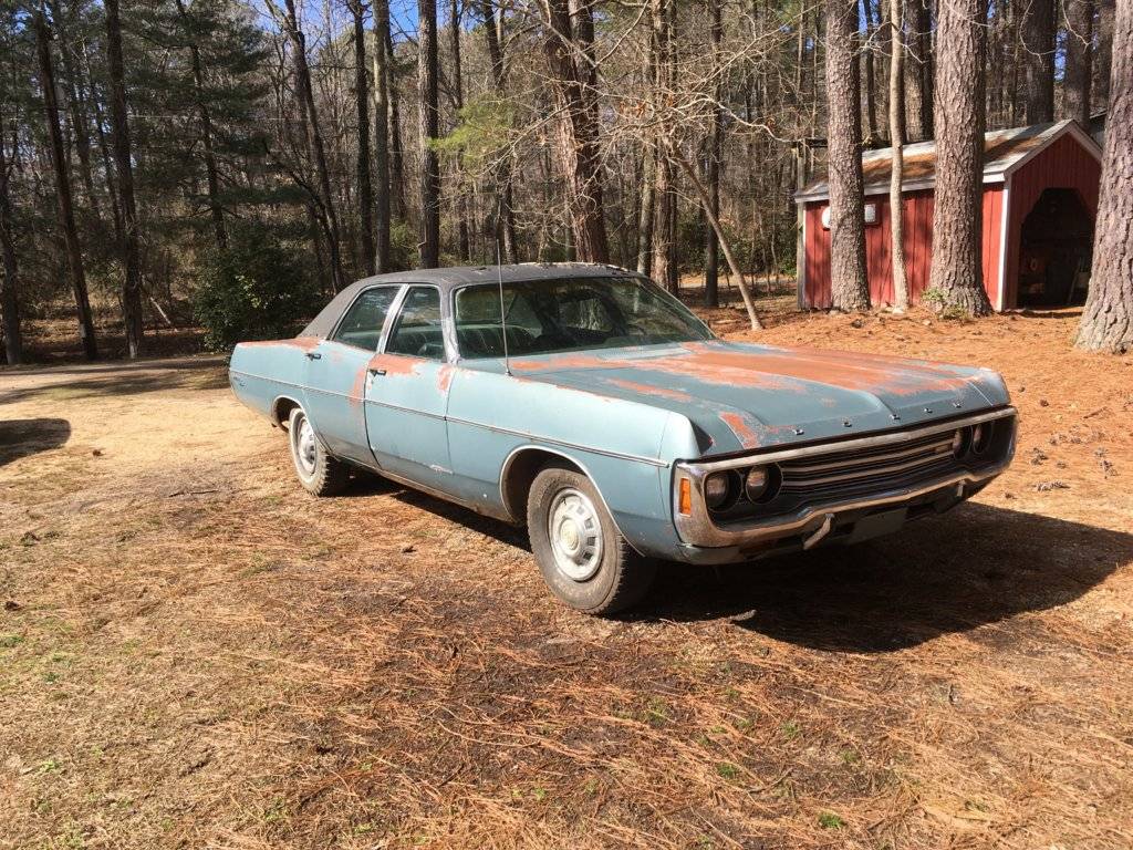

Look's like Delmae is happy. Evening picture, all the original lights working, and the original license plates back on it (Maryland changed their plate design in 1975, which these are still stickered as).

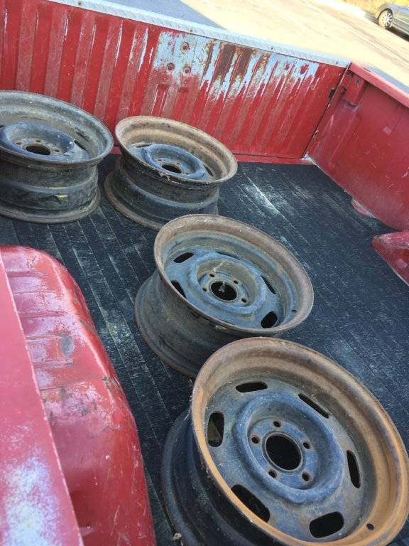

My $100 Cop Rally wheels. Patina even matches Delmae. Notice no holes for a center section. May spruce them up with 1971 Rally wheel center sections (after I drill holes) and possibly trim rings.

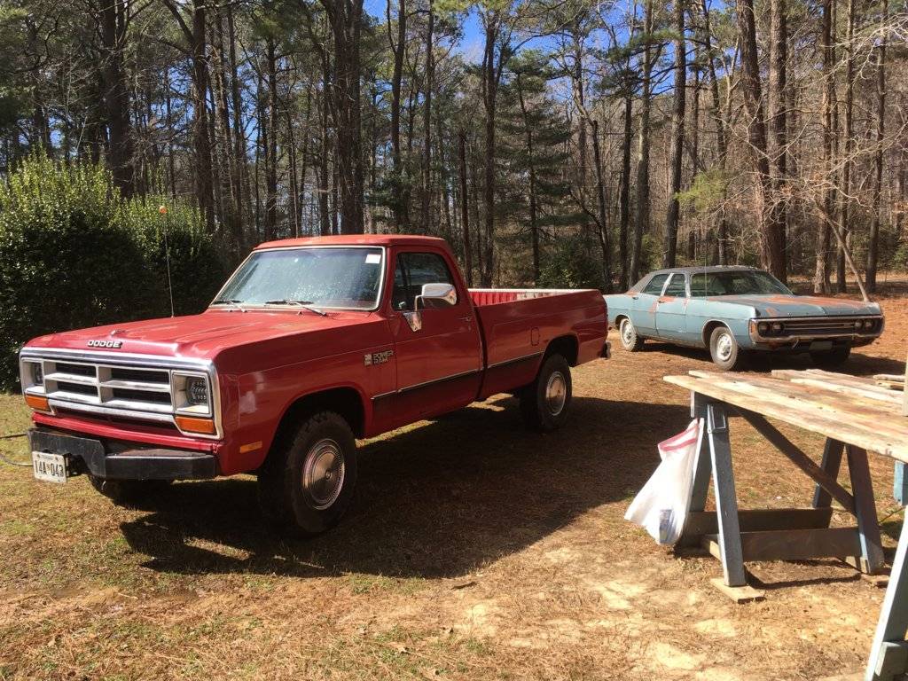

Finally I end my pictures with this one. Delmae sitting in her corner under a tarp with my first first gen and my second first gen. Reason I chose this photo to include was it was the very first time since 1993 that all 3 vehicles were in the same place at the same time. And coincidentally, all 3 were driven by dad to college as well.
