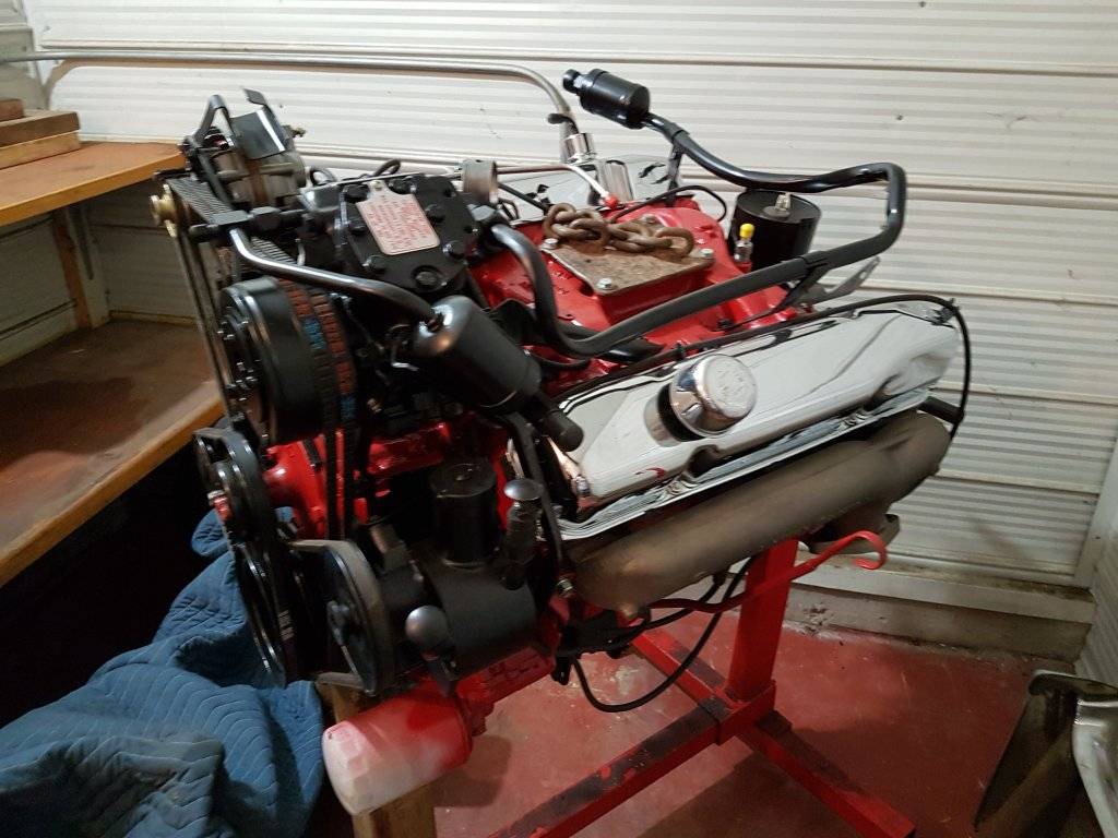

Here's my Monaco engine... Red with black accessories...

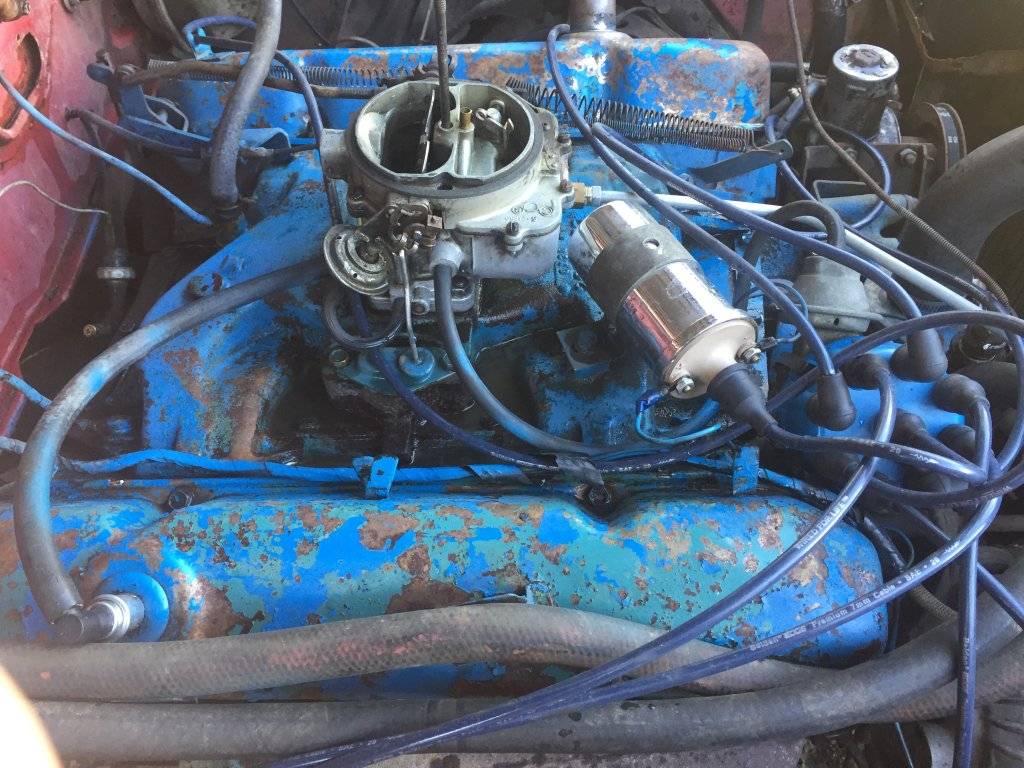

My engine was originally turquoise - you can see the paint under the flakes of the repaint to 1970’s Chrysler blue.
Obviously at some point someone thought they’d repaint it and either could not get turquoise or got the wrong colour and went ahead with it anyway. (See before photo)
