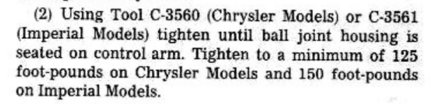

For 1966 Chrysler upper ball joints, use Miller C-3560 ball joint socket. This socket is generically specified as 1-15/16" / 1-59/64" in size. OTC specifies it as 1-59/64". (OTC is the modern company that was Miller, et.al.)
The larger 2-1/8" / 2-9/64" ball joint socket is Miller C-3561 which is for the larger Imperial ball joints. OTC specifies it as 2-9/64".
The dual sizing is due to different sources interpretation of the odd shape of the socket and ball joint compared to conventional sockets.
From the 1966 Chrysler service manual:

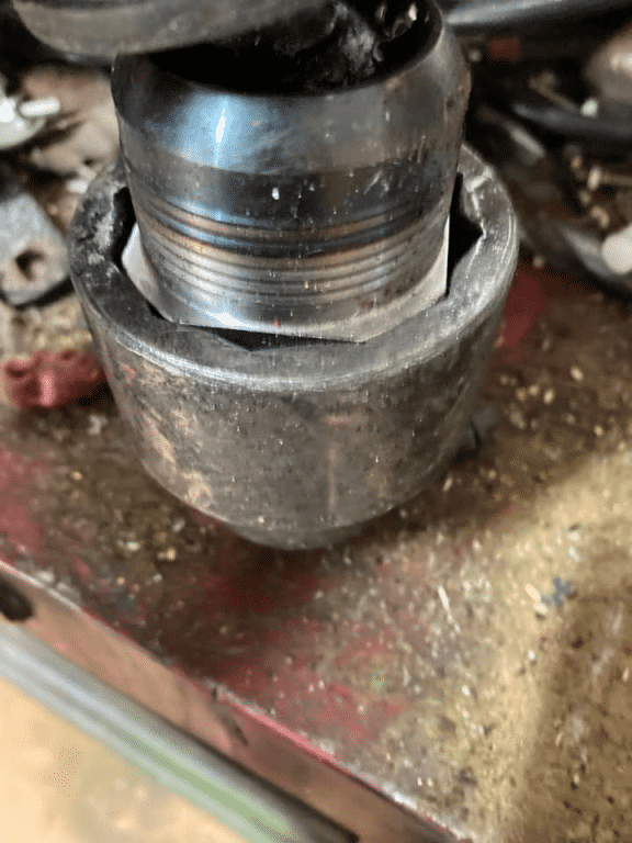

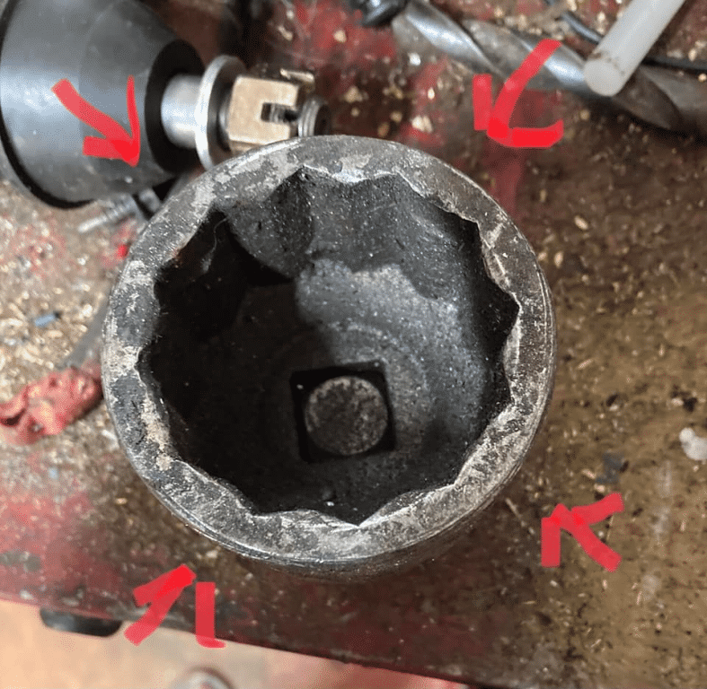

I've got a 67 Phoenix/Fury, and the ball joints were 1-59/64" as well. You could also get a 50mm 12 sided socket, and grind out some of the slots to get it to fit. I tried to get it off with a 6 ft breaker bar but it never budged. Buddy at work had a 1/2" impact that dished out 1500 ft-lb, even then it still put up a fight, but alas no match for the impact - zipped it off in about five seconds and flung grease everywhere haha. As per the factory manual, I threaded the new joint by hand as far as I could before zipping it up with the impact again. Bottomed it out on the flange...it's definitely tighter than 125 ft-lb.
If you're still unsure though, with the wheel off, grab your vernier calipers and measure on the flats. From memory, if it's 48.3mm you've got a 1-59/64" ball joint.
Found a pic of someone that modified a 50mm socket:
