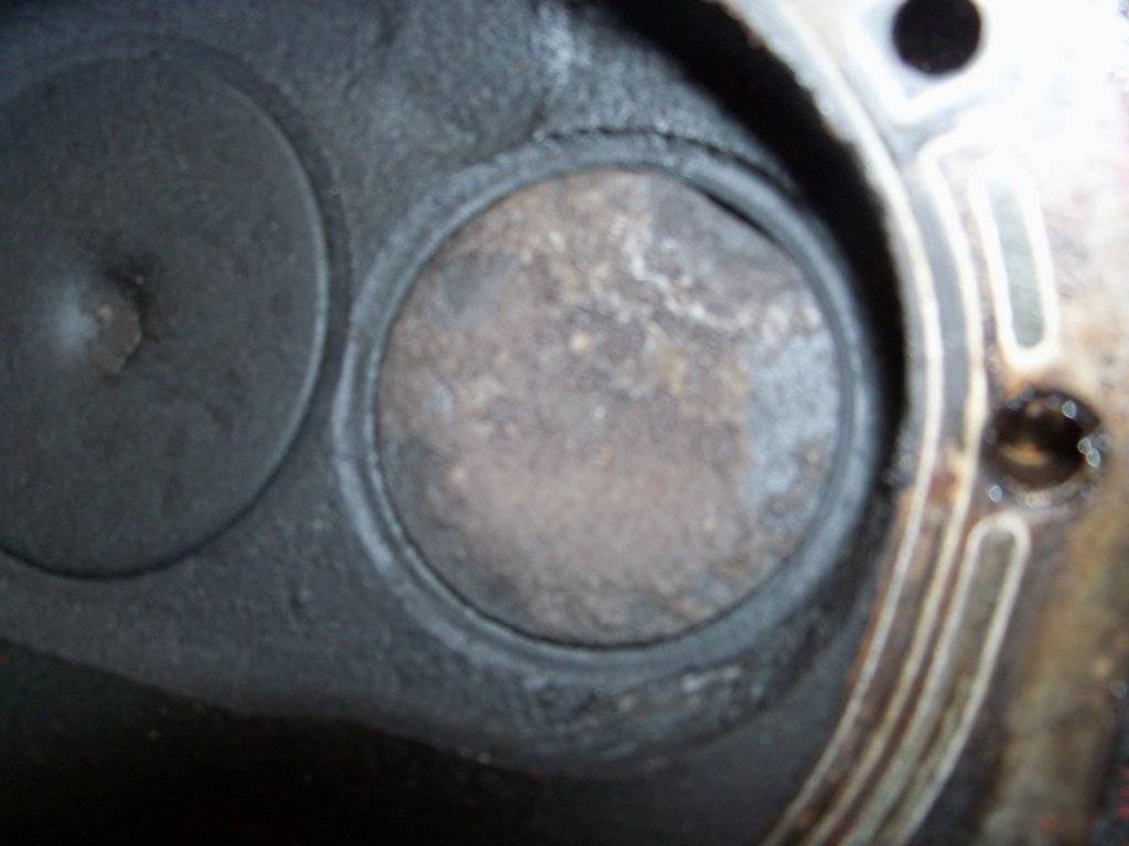

My .02. I think all good suggestions but I'd go with CBODY67 'cuz I think he'z on the right track talking about the Accelerator Pump not functioning properly and now my story az to why. In the mid '80s after I became caretaker of the 300 Hurst I added to the stable, I had the same issue with the 4bbl. AVS it came with. Also at that time I'd been befriended by a Chrysler Tech that became my go to guy in Ann Arbor, Mi. That knew hiz KA-KAH inside and out and lived less then a mile from me. He said I'll drop over this Saturday If that O.K. and I said I'll have the beer cold and waiting. He showed up and we jumped in the Hurst with me az the passenger and we went for a ride. After 3-4 hole shots we came back to our place . Upped the hood and disassembled the top of the AVS so he then could remove and disassemble the Accelerator Pump spring. He stretched the spring out holding it between his fingers and thumbs of both handz adding MAYBE 1/2 INCH TO THE ENTIRE LENGTH OF THE SPRING, put it back together and we went for another 3-4 hole shot ride. ABSOLUTELY NO MORE STUMBLE. End of story, Jer
66 300 383 4bbl.
#7 burnt valve.
Got rid of the small valve 516 heads and poor flowing original 4bbl intake.
Used a 301 casting 68-70 intake with a fresh set of 452 heads.
Pertronix ignition and 625 CFM Eddy electric choke with heat crossover blocked off.
1 inch spacer under the carb and 14 inch open air filter.
TTi 2.5 exhaust system. 18 MPG on a 278,000 bottom end.
Drove her to Carlisle in 2016 after being off the road since 1998
Intitial timing is at 11 degrees with 35 degrees all in at 2500 RPM.
2.76 gears with 2157514 tires.
