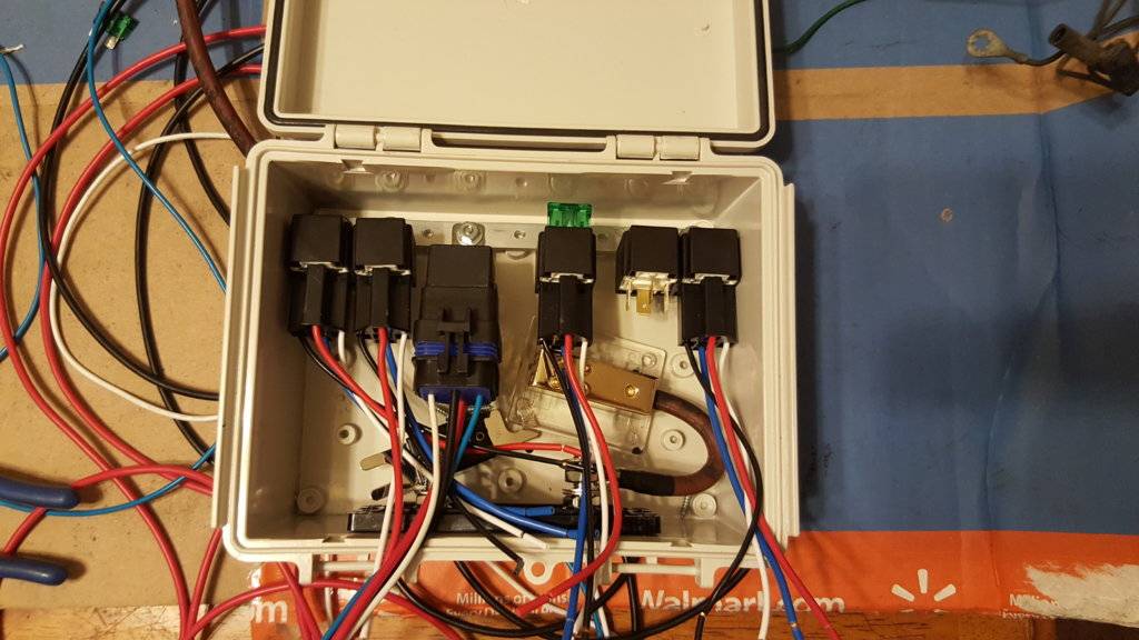

just test fitting all 6 relays... everything is still loose. hope this box is large enough. the big honking relay (#3 from left) is what cold-case radiators supplies in their fan install wiring kit - note the waterproof boot. good stuff maynard.

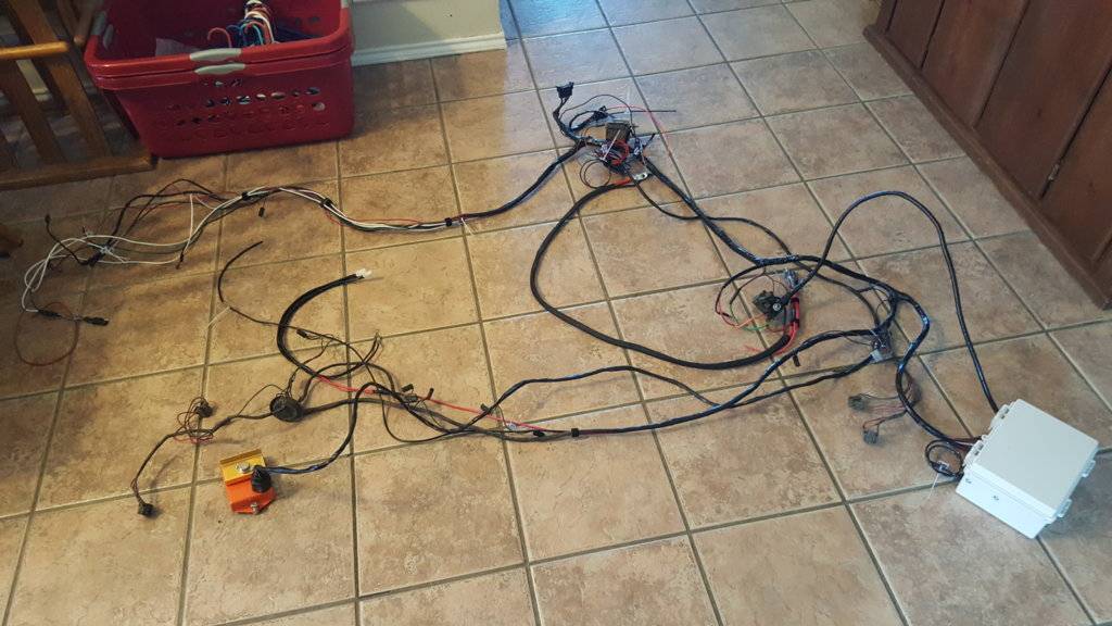

stardate 0U812.011318: engine compartment wiring harness R&R + upgrade complete:
added 6 qty relays in the tan box:
relays for lo / hi beam headlamps
fan relay
fuel pump relay
wolo horn relay
spare relay for future use
added elec. dist orange box into harness.
added 10ga. lead wire w/30A fused going into cabin area for accessories like USB, stereo, charging ports, etc.
nacho ammeter bypass wired into harness
new fusible links into harness.

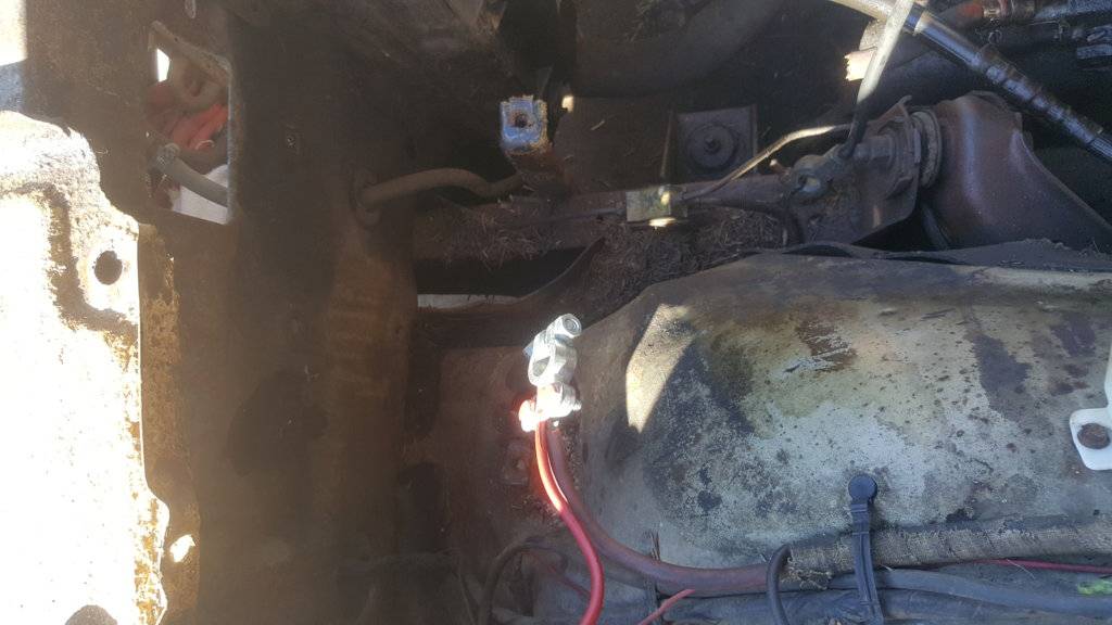

replaced melted bulkhead connector and ran bypass wire thru to complete the RED/BLK wiring at ammeter.
new starter cable / new + battery terminal
wired oil pressure kill switch into harness
wired fan thermoswitch into harness
wired fuel pump wiring into harness
remote wire for fuel pump @ dash
remote wire for wolo horn at dash
I left the very tail unwrapped still as I do not know the final position of the stuff I added - oil pressure kill switch and fan thermosensor... still a few open wires at the end

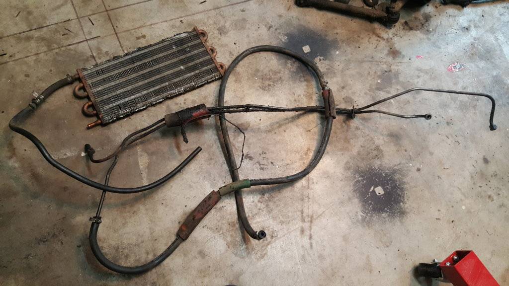

so here are the transmission lines and cooler:
whats my move here? the cold case radiator has ports for transmission lines, but this was all on the car when I got it.
My guess is that cooler was added at some point. Either that or it was tossed back in after the Ac evaporator was removed. To me, it does not look like what I would expect to be a stock item. It does not have a frame for any proper mounting.
My recall is it was just laying loose behind the grill.

Thanks for documenting, relays look like a good way to reduce resistance in the headlight circuit.. The only non functional item my Fury will get is purple halo lights. The wife likes them.
Keep up the good work, Try not to fry.
re: headlight relays -
I dunno if I previously mentioned it ^^ or not but all you have to do is cut into the HI / LO wires with your relay - it was pretty easy. one relay for each wire. on the wires you cut - the side coming from the cabin / foot switch is your '86' trigger wire on the relay and 87 out is the other end of where you cut the wire - just put it right back onto 87 and blam.
the headlight relay 'kit' you can buy plugs into the actual socket so no cutting into wires at all. very clean solution.
