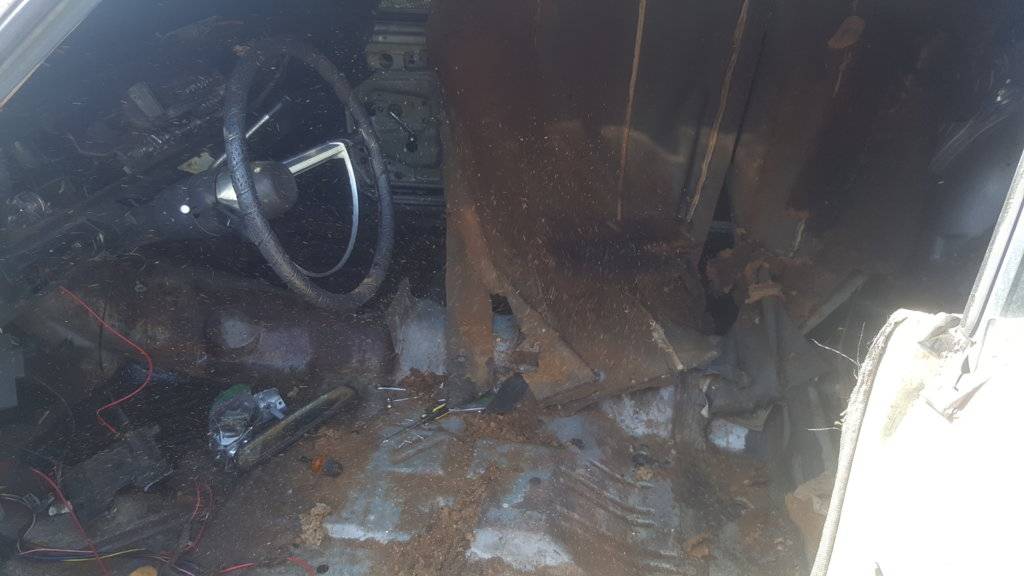

I had illegals living under the back seat. they are now evicted. I dunno if they were from OR or TX. one of them had flip flops on and a beardneck
That back seat was illegal free a couple of days before the car left here.:) cause that's when I put the seats back in.

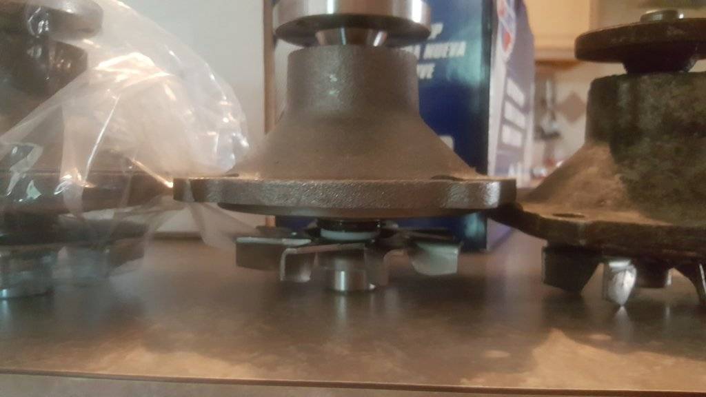

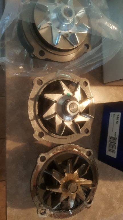

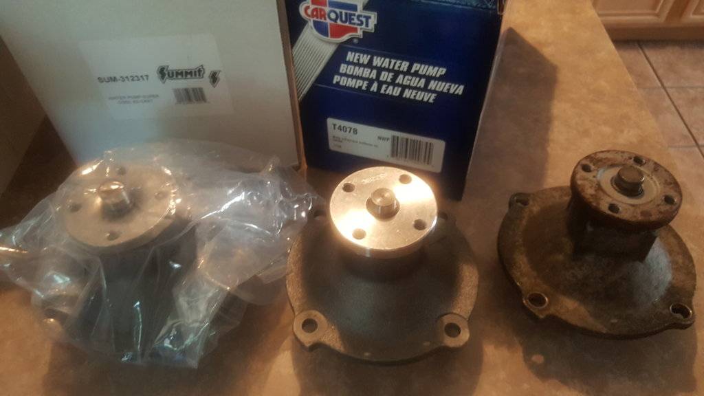

so I smuggled a water pump out of the summit stockroom. and it totally was not the same size as what I removed from the stock motor, so I went to advance and got their version:
all 3 of them are different height.
and all 3 have very different cavities underneath. summit / carquest / stock:
the summit has a plate, and open cavity underneath.
the carquest has no plate, and open cavity.
the stock has some ribs inside the cavity.
both the summit and carquest version are noticeably heavier.
when holding the mount surfaces even with each other, the pulley wheel is about 'correct' compared to stock, but the fans will sit way deeper in the housing.
if it fits, we good?
whats my move?

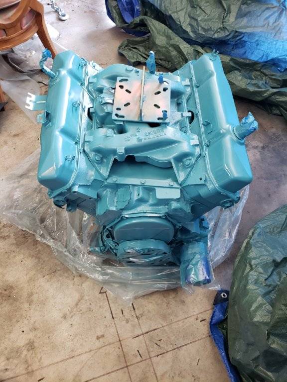

I wouldn't bother with it but was the gasket made in China? Better goop it up if it was to be on the safe side. You going to paint the engine? (What color?)
There's a certain beauty to a freshly painted, stock appearing engine that's pleasing to the eye and soul.
that's probably the best compliment so far, thanks friend. I guess I done good huh? :)
it sure is sexah lookin. 2 cans of spray bomb VHT Carolina blue / early Chrysler blue. I POR-15d all the brackets pulleys and supports that will go on here. VHT silver exhaust paint on the log manifolds - we will see how long that lasts..

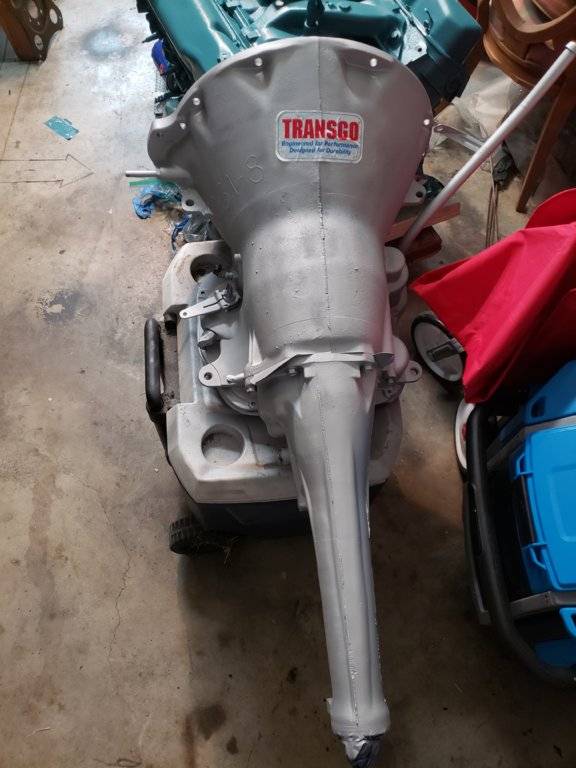

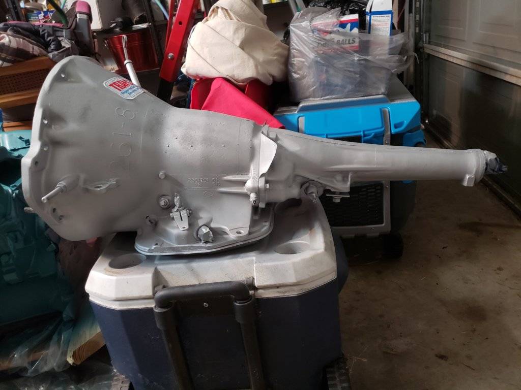

got muh boat anchor back today:
jeff at plano transmissions comes through again. if you are anywhere near DFW this is your shop for your chrysler 727 (he loves fomoco also) transmissions.
transgo stage 2 kit
all hd everything / all USA made where possible parts
2200 stall converter
full rebuild.
$950 out the door.
all day long baby

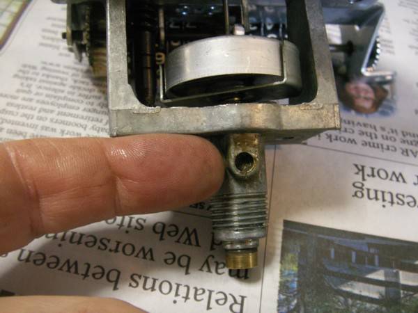

is there an oily wick in the 1968 (fury) speedometer that needs to be oiled?
pic related, but not a fury speedo . . . .

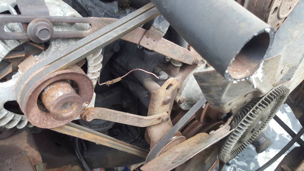

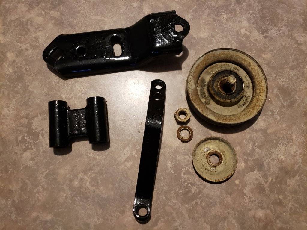

anyone have an idea on how to change this bearing in this idler wheel?
440 idler pulley
Saylor: I think yer gonna need a new idler pulley.
Don't get me started on the stamped metal idler pulley's, when I did the cam belt on mom's Reliant the idler was singing, couldn't pop the seals off the bearing and clean & re-lube the bearing like I did on the alternator, soooo call local dealer, no got, contemplate drilling out spot welds to get at bearing, (now where was my rivet collection) nope, hit phone and find one at dealer 2 towns away, get someone with brains on phone and let'em know who I was and wanted 'Jobber' price, go to fetch and counter guy want's list ($90) make noise to get guy in office to come out and give me agreed on price. Ask for brushes for alternator, no got, they just replace whole alternator and that's $250, guy in office reminds me of re-builder shop on way back home that I had dealings with many years before, stopped there and got 2 sets @ $1.50 each, end of day job is all done and mom is happy!
