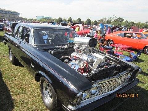

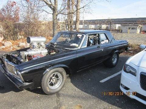

Hi welcome. To answer your question, yes it can be done. First off ,what year fury is it? Then you would need the puhbutton trans. and driveshaft from a mopar car 64 and older...65 trans. may work also because those were cable shift too. 66 and up they used rods to shift the trans. A buddy over at F.B.B.O built a cool console for his 63 plymouth fury race car..pushbutton is like 2 ft. above the floor hump.Put it this way when your slingshotting off the line in a blown HEMI pinned to the seat,you dont want to blow a shift..Ill see if I can find some pics....John

Hooters%2011%2030%20%2014%20Part%203%20(4).JPGEisenhower%20Show%209%20%2028%20%2014%20Pt%204%20(12).JPG
