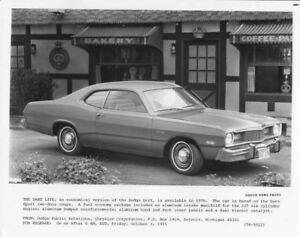

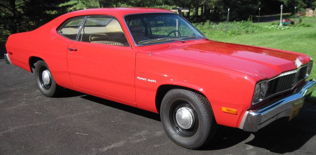

How about the very abbreviated version?
The father of a guy I worked with had one for sale. It was dirt cheap, had a bad frame rail. Otherwise it was pretty nice. This was about 1982 or so.
I had a 69 383 Dart that someone had put fender well headers on and I needed patch panels and I figured that if nothing else, I'd use the panels.
I went up to pick it up with my buddy Charlie. I paid the guy and Charlie said "I want to drive the Dart". Charlie had '68 340 Dart that he raced. We got to the first stop sign and he flashes his lights and jumps out. I figure there's something wrong... We're an hour from home too. He's really animated and he's yelling "I want this car!!!". Charlie was/still is a great friend and I couldn't say no, so I tell him we'll just take it to his place. So... I owned it for about 5 minutes.
He still owns the car! Won a Galen Govier award at the Englishtown Mopar show with it too!
