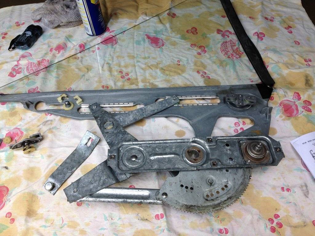

Working on the quarter windows on my 65 300 Vert. Need new quarter window rollers. Anyone know if B Body rollers will work?

There are at least two maybe three different rollers in that mechanism.

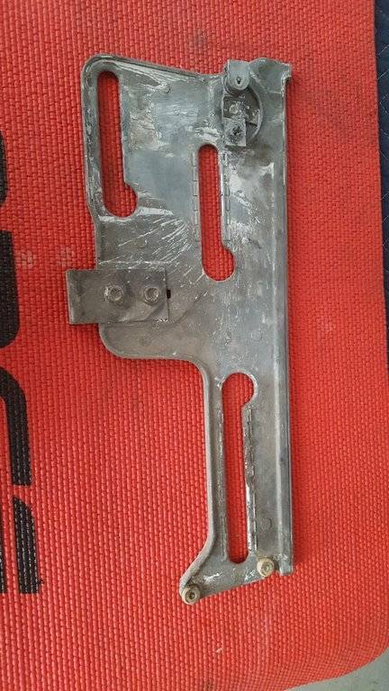

This a pic of a 65 Monaco drivers side quarter window.
The guide roller shown in post #4 is the front upper guide roller. The lower front guide roller is the broken one on the left. It has a roller that engages a slot in the regulator. I belief these are "C" body only and hard to find. Also, the broken roller with the square slide block is unique to "C"s.
Call a scrap yard or Murray Park.
I beleve the 65 "C" three roller guide has a swivel on the 3rd roller post.

This is what I have. The main roller broke. I have some miscellaneous rollers I can use
