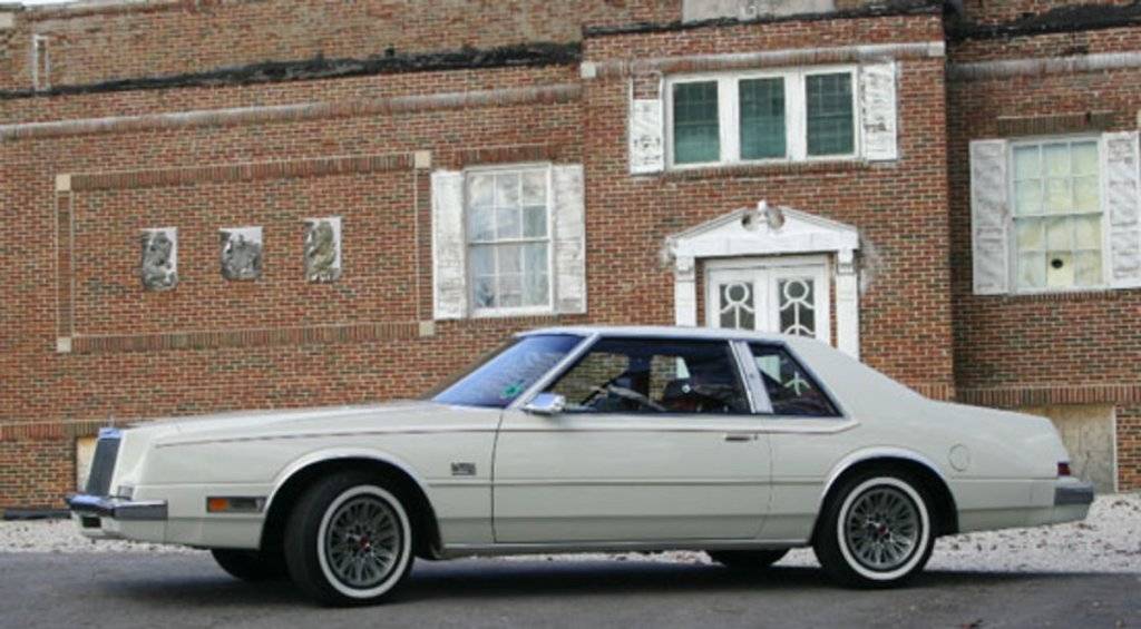

U actually considered parting the car out and buying a 83 imperial I know of, keeping the wheels, tires, and motor, and swapping the 400 into it.
The body is good and the paint is good about the same or better condition as my newport, the guy wants $800 for the whole car. It ran 3 years ago but I dont trust a 318 EFI.

The 400 isn't an easy swap into that Imperial. In fact it would be a huge project that I would try to discourage you from trying.
I admit I would have a hard time passing it up, but I'd stay with a small block in that Imperial.
Yeah looking into it thats a terrible amount of work, having to pull all that electronic wiring vacuum bs and replace it with new parts that don't exist aren't exactly handy. Its more time then its worth.

Wow, I would take that Imp for 800. I would guess the rear is broken in car. If the trans died that easy it was bad to begin with.
Doesn't the Chry V10 have the LA bellhousing bolt pattern on the block, since that's the basic architecture it was expanded from?
A stroker 408 LA motor would fit better in the Imperial, with a modern self-learn EFI on it, too. Or even a salvage yard 360 EFI motor, for that matter. Most of the Imperial's EFI is in on the air cleaner base "plate", as I recall. If it's running flakily, it might just need the band clamp on the air cleaner secured with NO air leaks around the edge of the air cleaner . . . as simple as that might sound, the MAF is in the air cleaner snorkle. Remove the air cleaner top with the engine running, loss of air flow signal kills the engine.
