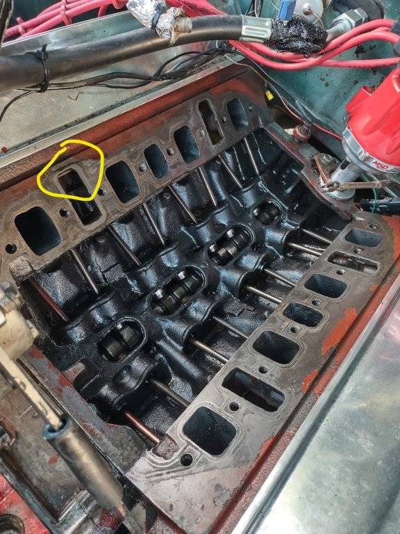

I recently swapped the intake manifold on my 318 Poly to go from a 2-BBL to a 4-BBL carburetor. Pardon me for not knowing the exact terminology but I noticed that in the cavity where the water and coolant passes through the heads that there's a thin metal rod (about the diameter of wire clothes hanger) that runs through it. What is it and what's it for? On one side it seemed dislodged from where it was supposed to be (comparing it to the other side). You can see it circled in this picture.

The "coat hanger looking stuff" inside cylinder heads is from the sand-casting procedure, they helped keep the mold shaped while the iron was poured. When the sand was removed, the wires stay behind.

Thanks for your response. So, if I'm understanding that correctly, they serve no functional purpose in the running of the engine. The reason I ask is that, as I mentioned in the original post, one of them (on the passenger side head) was kind floating around in there, not attached to anything. I felt the other side and it seemed firmly installed. I couldn't figure out a way to attach the loose one correctly so I decided to do a delete on it. I figured the engine had been running fine so it couldn't serve a mission critical purpose and having something loose in there wasn't very appealing.
