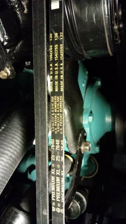

I wasn't sure about the belts but I knew that Continental had taken over Goodyear's hose operation....wound up going through at least a half dozen Gates belts from NAPA till finally found 2 who's sequence numbers were close enough and then returned the others...when belts are made they are made in a tube then are sliced off one by one...and the diameter of the tube can vary from one end to the other...there are numbers on that roll and ideally you'd want them to be one number off....when I hit the shop tomorrow I'll post a pic of where that number is located...on my 440 the double belt only runs the a/c and alternator...when the a/c idler bearing seized made the hour drive home on the battery with no problems ...as long as the lights are off it takes very little juice to run the car...water pump and power steering had their own belts
The 135 136 137 are the sequence...so as close to the previous 3 or the next 3 as you can get
