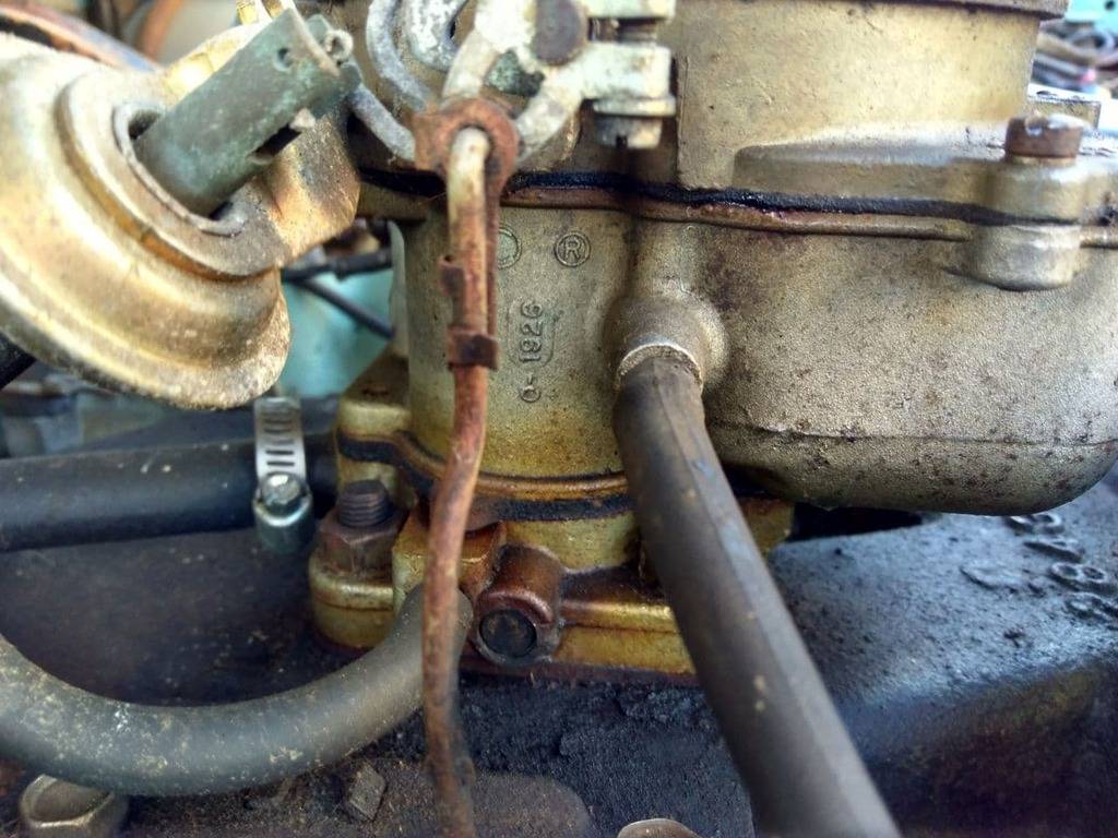

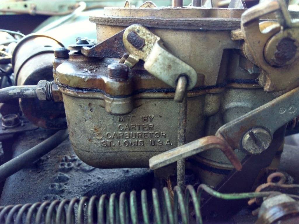

I actually have a few pictures of the carb itself on my PC, take a look at them to see if anything sticks out that could be an issue (if anything else it's worth a shot).
I would assume a large part of it is the absolutely junked gaskets, which is why I want to rebuild this engine at some point.

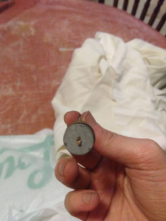

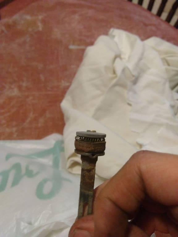

Today I decided that I should finally just tackle this head on, bolted off the carb, and took it apart. My hypothesis for the while was the accelerator pump was rotted and bad (I don't even think this carb has ever been opened, and if it has it was a long while ago). It seems my hypothesis was true, as this is what I found once I did:
So, needless to say, I replaced that part, put a new accelerator pump in, check ball was free and in place once I did it, put it back together as I found it and even cleaned it while it was apart. Even checked the choke diaphragm to see if it was rotted, sucked on it and nope, that works as well. I'm hoping that will also solve my issue of the car sputtering from a cold start. Thought it was the choke for the longest time but I guess not.
