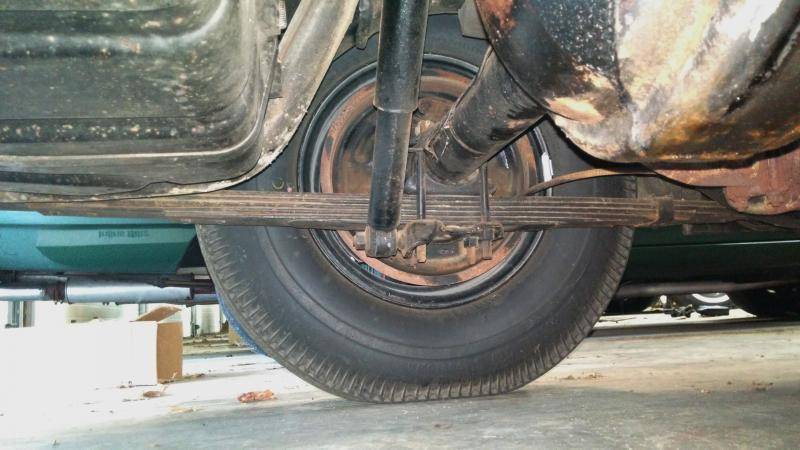

I took this pic of a spring on the 70 yesterday. Looks like a 5 leaf, and appears to have little, if any, arc to it. There is no additional weight in the car now. Does this look normal?
Yes, for a 45 year old spring..
If it were new? No.
I disagree with Will on this one. .... The springs have plenty to do with stability.

Considering that the springs and torsion bars are the basic difference between this car and my incredibly good handling 69 Fury...I'd say so as well.
The 69 fury, and your 70 fury use the same length, width, and locating pin spot as your 70 does. The best thing to do is if you like how the 69 rides order that amount of springs for the 70. Yes shocks play a role in dampening but they don't control body roll, and sway.
I'm looking for something inbetween the two cars as far as springs. I haven't looked closely, but I suspect the '69 has 7 leaf springs...probably the stiffest available in '69. Surely, there was something available in '70 between these little 5 leaf ones and the monsters on the '69.
