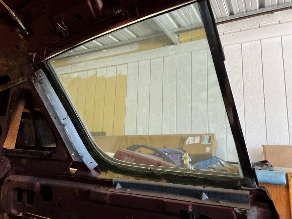

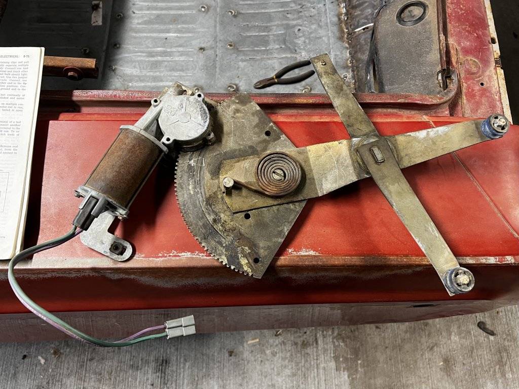

Currently stuck trying to remove the rear quarter glass window motor / regulator mechanism. Do I need to loosen any part of the window track in order to make clearance for the window motor?
Or any tips you may have? FSM isn’t very helpful for removal of these motors…
Long, long ago, I managed to remove the rear regulators from my '66 New Yorker coupe without messing with the window tracks. I'm not sure if the fast tops are more difficult than the standard coupes.
I think Chrysler wants you to pop the clips off of the rollers to get them out. I think you can get the clips separately, but a quick search only brought up complete roller kits.
Jeff
Jeff
My exact thoughts! I ended up having to remove basically the entire track… what a pain!
