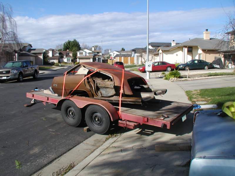

Don't think about it, just get it done quick. I like a medium tooth blade in a reciprocating saw. Keep the tool low, almost laying on the panel and draw it through.

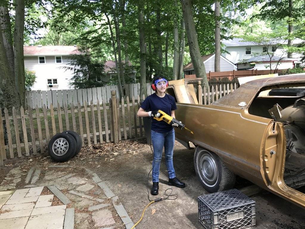

Lol, sorry, Matt, that was a case of “fat fingers”. Those cutters are the best out there, make sure to use plenty of oil.
My suggestion is to invite the locals to cut the car up, they
will have lots of fun and get rid of “that nieghbor’s junk car” at the same time.
