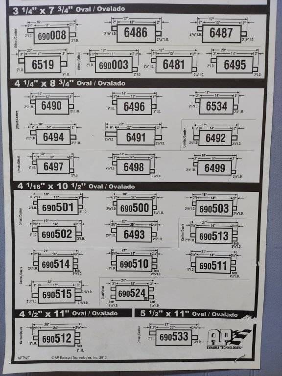

Here you go gentlemen, all AP exhaust's Turbo Mufflers. You'll have to zoom in for the sizes.

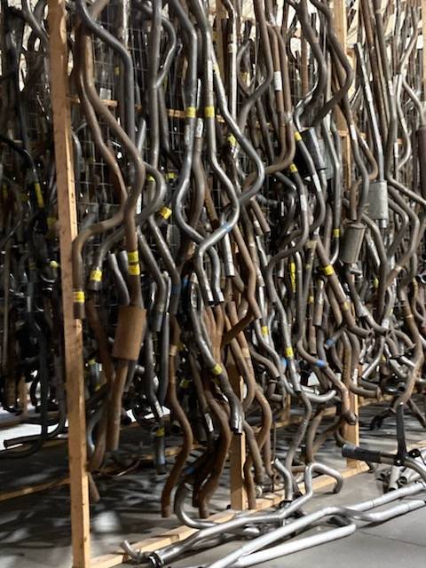

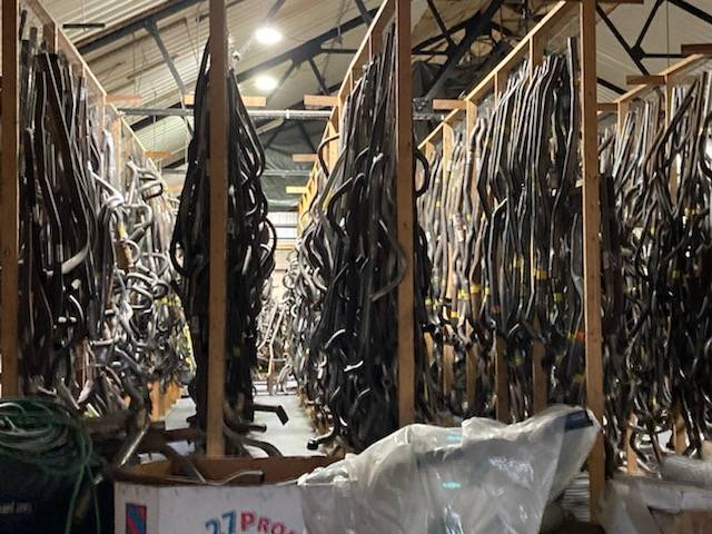

I replaced the hatchet job dual exhaust on the Part barge ('65 Newport 383 2V) with the stock single from Waldron.
Great fit and quiet too. Here a couple of pics I took of their shop when I picked up the exhaust several weeks ago.
