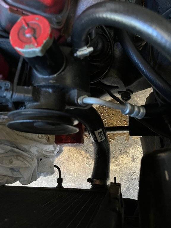

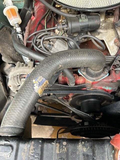

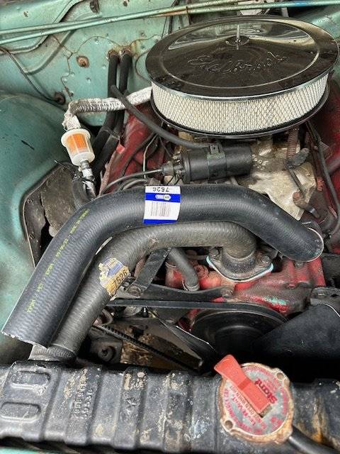

If any of you can, please send a pic of engine looking down at upper hose. I've had the same problem with my '66 Polara 383. It's non-AC, and the the upper hose is on the passenger side (not center like original ones I've seen). It's not the original radiator, was replaced with a 26" Chrysler radiator with this serial # 2998965 stamped on top, then below that 59536. My research so far says that it comes from Fuselage era 69 or 70 big blocks. Fortunately the Gates # 20558 DID work for the lower hose replacement. The prior owner had a NAPA 7526 on the upper, and I just bought the exact # replacement at NAPA, and it doesn't work.

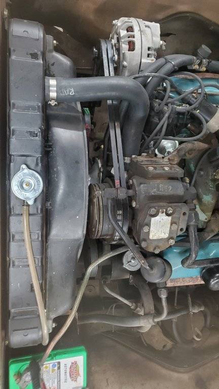

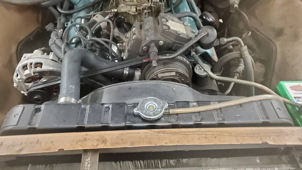

See the above posts. The industry number 332 radiator fits my '67 Newport 383 w/ac and also my '70 Monaco 383 4bbl w/ac. The aftermarket hoses are "cut to length", with an appropriate "ink line" location to shorten them. The one on my Monaco looks just like a '70 B/E-body 383 hose w/ac.
Go into the NAPA online parts lookup and see what they might show. Then do the same at www.rockauto.com and see what Gates shows. Should be illustrations and specs for each one. Might be that NAPA has a batch of those hoses which are mis-tagged?
