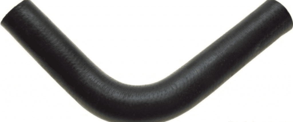

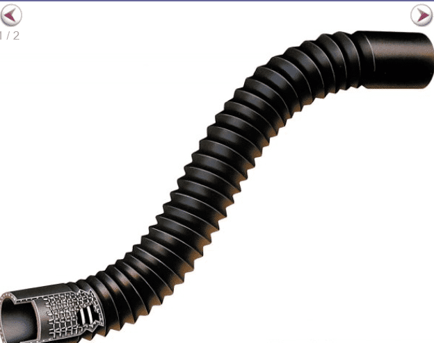

Does anyone have any thoughts concerning the best type of radiator hoses to use?
This debate has probably been brought up many times.
Flexible ribbed hoses- Picture 1
or
Molded Rubber Hoses- Picture 2
I know it's important to have the springs in the hoses to prevent radiator hose collapse, especially on the lower radiator hose.
Though what do you recommend? I want to change mine because they are worn out.

The stock hoses are the molded rubber ones and are the better choice if you can find them, less stress on the upper and lower hose bib for the radiator. Be sure if you use the molded hose on the lower to install the anti collapse spring native to the lower molded hose. Gates probably makes the best after market hoses with Dayco in a close second.

I'll agree, NEW Gates are probably the best option in MOLDED hoses. Fluid flow in the molded hoses will always be better in the molded hoses than in the "universal" ones.
Depending upon the model year, the C-body hose is very similar to the B- and E-body upper hoses. Go into the Gates website and look in their online catalog FIRST. There should be some illustrations of the curves, bends, and such for each hose. They'll also probably have ink marks of where to cut for various applications.

Agree with all advice given... the flex hoses are really only good for an emergency... you would be surprised how many have caused a radiator nipple to break free/leak. Impatience and laziness are the only excuses for using them for most cars.
