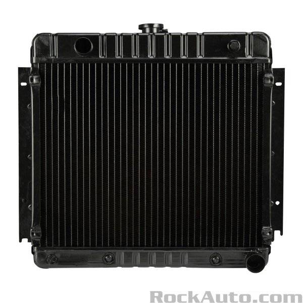

    I went with the CU526 from Spectra. It fits the original mounting holes and the ports are on the correct side for the 340. Originally for a '71 Dart. A shroud is also available.
