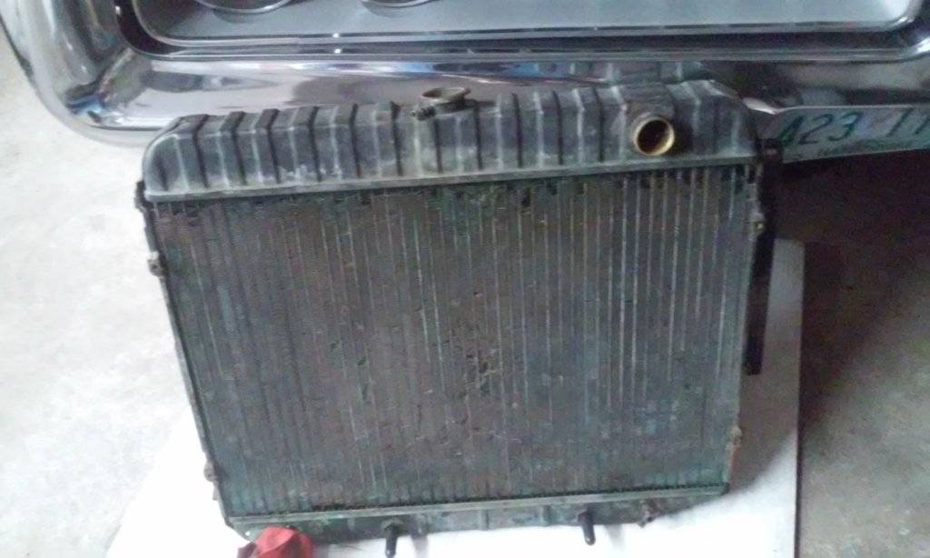

I pulled the radiator on my '67 newport as it was leaking. I found there is a long crack from front to back on the bottom. I assume this material is aluminum but I am not sure. It has a gold tone to it. Would it be possible this bottom part of the radiator is brass, bronze, or copper? It was covered in green corrosion as well. This looks to be the original radiator. I hope to be able to braze this up as soon as I know what material it is.
All parts are brass, soldered together with lead solder. By observation, there are apparently different qualities of lead solder in the radiator shop industry. Reason I say that is that when there were radiator shops in every small town, those clean and re-solder jobs usually lasted about two years. Similar repair from a big-city high volume shop lasted several years longer. Solder cracks were the issue, rather than it breaking loose from poor adhesion.
Be sure to check the thinness of the flange where the crack is. It might be too thin to clean and "make solid" again. The color of the corrosion you found is from the (generally) green-colored antifreeze used in normal vehicles (meaning non-DexCool or any other special later-model coolant).
It would be best to get everything apart, as the heat you might apply to that area could melt the existing solder between the flange and the tank, causing more work than you might have desired. IF you clean one side, the other side will still be "dirty", so that would compromise any "in-place" repair you might make.

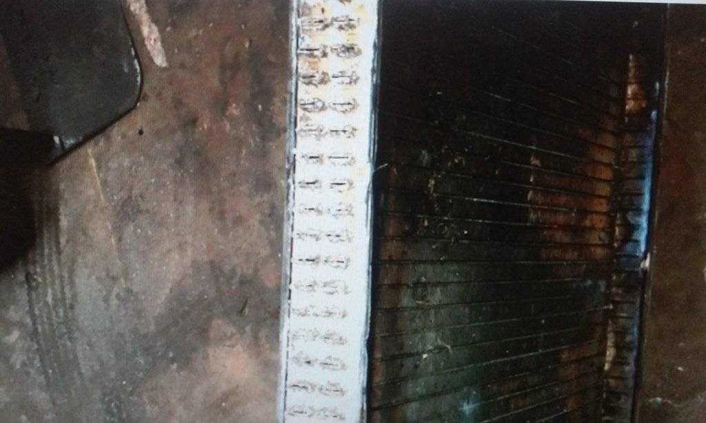

just sent my radiator out to get re cored last trip of the summer and it let go just as i was parling it in the garage
just got a picture of the radiator after the repair shop opened it up and the car was running cool .
it should run alot cooler now
