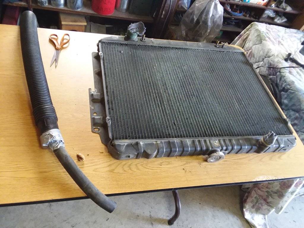

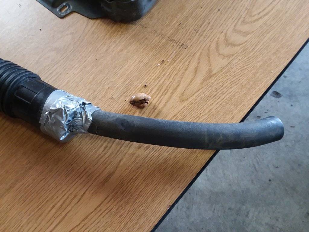

Not C-Body, but Dodge and hoping for help: I am facing replacing the radiator in my 1990 W150 pickup truck. I was thinking of using a van radiator that I have from a 1992 B350. The B350 radiator had been sitting in a corner of my garage. When I picked it up, I heard things rolling in the lower tank. It turned out to be pieces of acorns. Some animal took the time to bring its acorns in my garage and store a few of them in the lower tank of the radiator. The biggest of the nuts is pictured by the duct tape/heater hose contraption that I made to clean out the lower tank. It actually clogged the heater hose. Who knew that squirrels or chipmunks would make such effort to find a way up into a garage and store food in a lower radiator tank? Lesson learned: ports plugged until install.

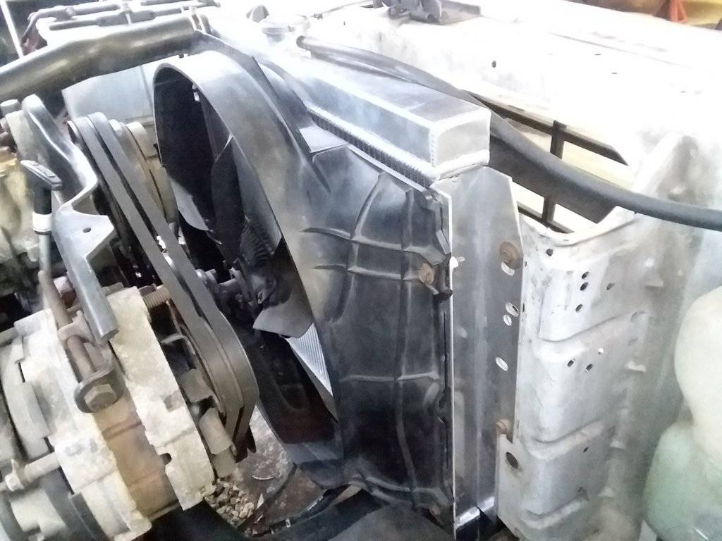

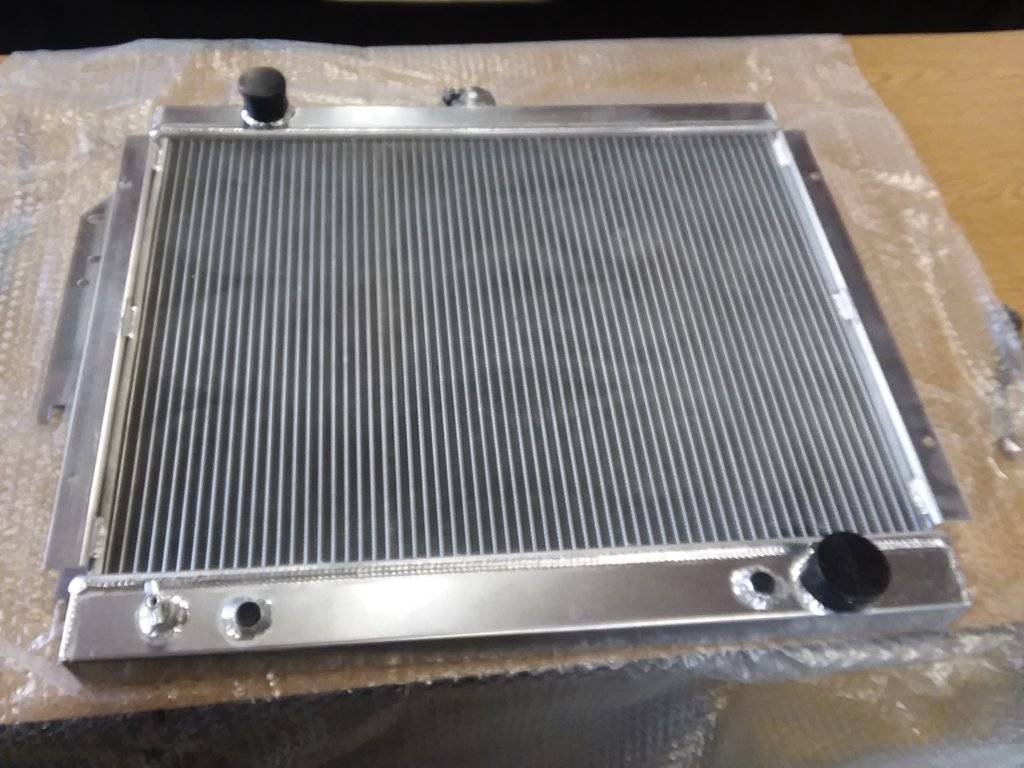

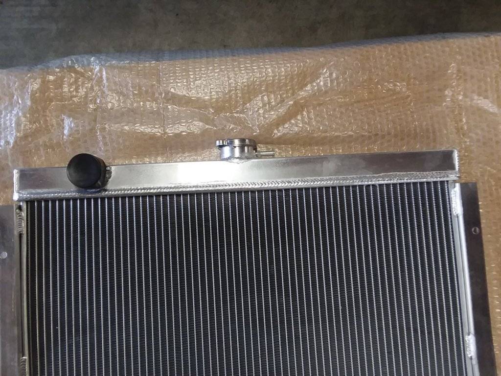

Thought I would update this thread, so there's an ending to the story. I decided to buy aluminum, all welded. I ordered this on ebay for $168
2 ROWS Aluminum Radiator 79-93 Dodge D150 D150,Ramcharger,W150 D150,W150 | eBay

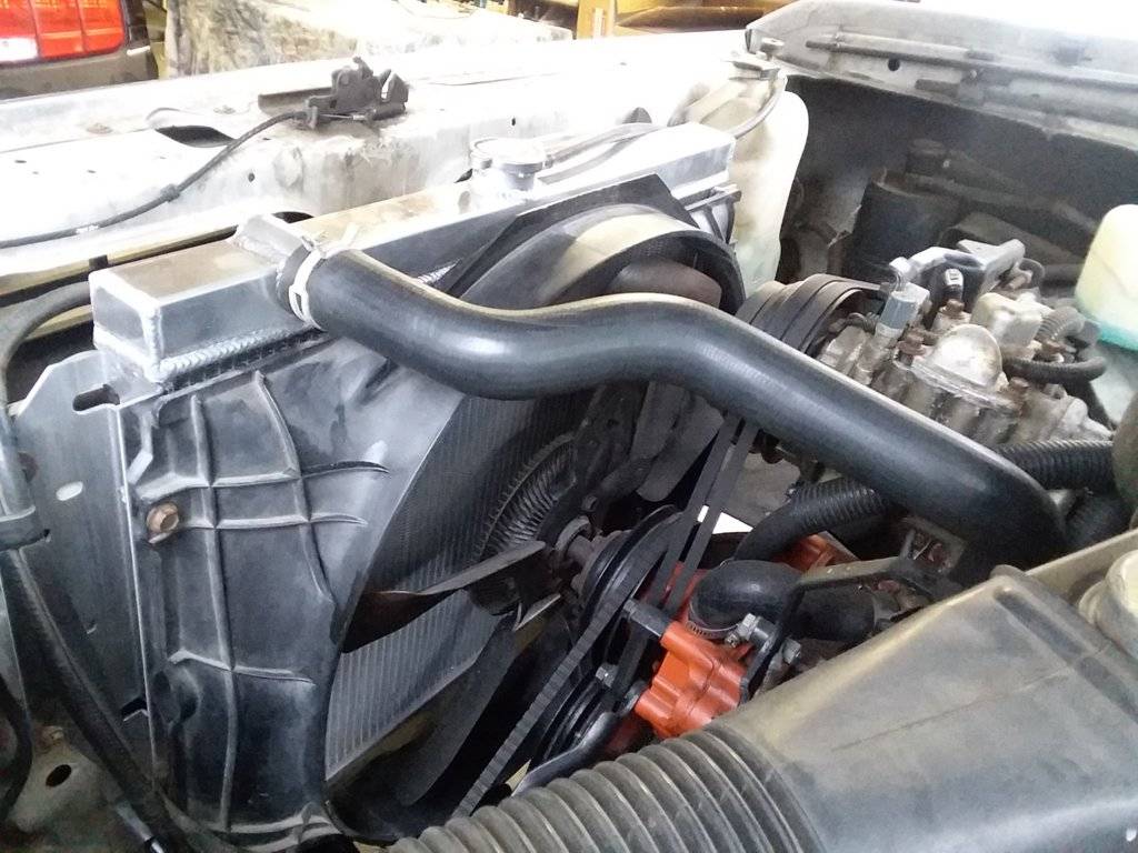

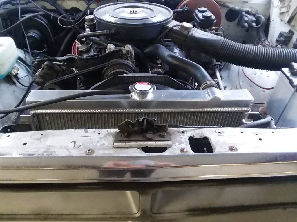

Installed stock location with stock fan shroud. I had to use my old trans oil fittings with male/female adapters, because the fittings in the package were too small ID for my hoses. Radiator much lighter than original. No leaks on test drive. :thumbsup: Thanks for the advice, see below
