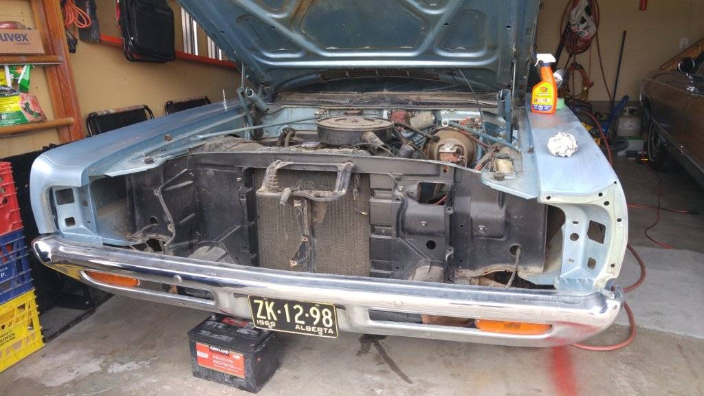

While inspecting our cars this week, critter and I noticed that there was a difference in the above noted items in our cars. I was taking the number from his lower rad hose so I could reference it at the parts store, and when we got to my place and looked at mine, the lower hose didn't exist in that location. Both cars are 318, non A/C, with a 19" rad. The 69 Monaco has the inlet on the driver's side, as well as the outlet. The 70 Fury has the inlet on the driver's side, and outlet on the passenger side. The upper hose is the same on both, and the lowers are different, of course. Seems odd that there would have been two different water pumps for the same spec. Anybody have a plausible reason for this discrepancy?
Does the Monaco have factory trailer tow? Just spitballing...
No trailer tow package. I would think with either the tow package or A/C, it would be at least a 22" rad as well. Only difference is 727 in the Monaco, and 904 in the Fury.

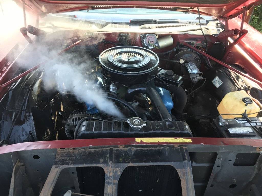

OK, updating this thread with my experience and some more questions.
As I have mentioned here and elsewhere, Poppy (aka my '70 Polara 'vert) still has its original non-A/C 318 and 19" radiator (Part number P/N 2998951). The car had 31,208 miles when I purchased it in late March 2018. Right after I bought it, I had (i) the water pump replaced, as the original was beyond hope and (ii) the original rad recored. I started driving the car at the end of the following month, in April 2018. Now, almost 15 months later, Poppy has been to two Carlisle shows and is just shy of 33,000 miles.
Here is my assessment of the cooling performance in those 1,750 miles:
1. Once it's hot outside (80+) and we're in town, the engine quickly starts to run hot. The temperature creeps up fairly fast: after a few minutes of driving in stop-and-go traffic, the temp meter needle reaches the high end of the "normal range bar", and after less than 5' it exceeds it (while staying in the range of non-lethal temps). Not great, as I have to try and avoid such situations -- and thus I have to overthink outings and routes.
2. As for the open road:
a. Last year, I did not have any issue with temps while driving on either small roads or highways (even when keeping up with the fast traffic on the outside lane). Temps outside did not matter: the needle was between the E and the M, just where I (and @71Polara383, who test-drove it with me while at Carlisle) like it.
b. This year, I had zero issue until this weekend -- but yesterday, Poppy overheated on the way back from Carlisle. This came after less than 75' of continuous driving time: 15' in Carlisle (got hot as per usual, but no overheating), 30' on small hilly roads at 40-60 mph (the temp quickly dropped but remained a bit higher than I usually see it, about 60% of the way right in the normal temp range vs. 40% usually), followed by about 30' on Route 15 (where I spent half of the time on the passing lane, driving with the fast traffic). Right around Emittsburg, just when I was thinking that life was really great, I smelled a burning smell: I looked at the temp gauge, and boy was it hot! I pulled over, saw steam coming out from the radiator top nipple (the steam pressure had blown away the overflow hose -- see pic below). I waited 20', then added a half gallon of distilled water. Afterwards, I had to stop every 15' to let the car cool down a bit, as temps kept creeping up after 5-10' of normal driving and reached the high end of my preferred range after about 15'.
Now for my questions: why?
--> Leaks? Don't think so. I had checked coolant level before heading out to Carlisle, and only needed to add a very tiny bit at that time to cover the gills inside. Every time I stopped on the way back from PA, I checked for leaks -- I saw none. Zero, zip. No marks in my garage either, ever. At first pass, it seems that leaks are out.
--> Hose spring? Don't think so. First, if there were a spring issue, I think that I should have had problems earlier. Second, my recollection is that, when Poppy was brought back in shape last April, my restorer and I did discuss putting an anti-collapse spring in the lower radiator hose -- otherwise, collapse and starvation would have been my first suspect. Still, I'll double-check with him tomorrow.
--> The thermostat is next in the suspect line-up. The original was replaced last year, but I just looked up the invoice and I was billed $14.75 for the one installed so I have no idea which brand the new one is (I made the same mistake as with the water pump, I did not discuss choices with my mechanic and did not keep brand records for parts in the early stages of the restoration). I am thinking that perhaps the new thermostat has already gone bad and in particular, as @Big_John might say, has started "to stick or open later" -- which would explain the seemingly inconsistent temp behavior (goes a bit up, then goes a bit down) that I observed in my last 20-30 miles of driving before parking the car yesterday. Regardless, as @mr. fix it stated, replacing the thermostat should not solve the "hot in stop-and-go traffic" issue.
--> Of course, there could be an issue with the recored radiator itself. I don't think the initial re-coring was the issue (otherwise, why did the car work perfectly once underway last year?). Maybe now there is a clog of some sort, but I doubt it. Yes, there is some oiliness in the coolant (see the second photo), though, so I'll have the system flushed anyways.
--> Next, I have to worry about the water pump flow?
(i) As mentioned above, I don't know the brand of the pump that was put in. Perhaps the thermostat / pump combo is not the ideal one?
(ii) more broadly, after reading this post from @Davea Lux about the importance of keeping the "pump mated to the clutch fan and the pulley size", I am wondering whether maybe I have mis-matched components? I doubt it in my case, as my restorer is a '60s-'70's Mopar specialist, but that is always possible. A question I will specifically ask him is whether the water pump housing is still the original one, or a replacement part (thanks to @CBODY67 for making me think of this possibility, and to @Rapidtrans777 for also suggesting to check the housing).
--> Finally, the radiator I have still has the original four-blade fan, but no fan shroud. I have not been able to find any factory shroud listed for my engine, but @1970FuryConv did manage to find a shroud and spacer. I've asked him for more details about it, and will post here when he responds -- and of course I am open to suggestions (pluses/minuses).
Look forward to hearing the best and brightest's collective opinions! If anyone disagrees with part or all of what I just wrote, or if I am missing an obvious item, please let me know where I am erring.

I suspect from what you describe it could one of several things. Have you checked the radiator fins on the core be grass seed or other debris that prevent proper air air flow. I think that a thermostat is the most likely, many of the ones sold these days at Auto Bone and Car Crap are made in China and are very poor quality. Go on line and buy yourself a Robert Shaw heavy duty t-stat. These are made here and are the best stock type t-stat on the market. If you car had a 4 blade fan from the factory it likely did not have a clutch fan or a shroud, most of those were found on 26" radiators. Mismatched components are not likely on a 318 non A/C car. I would suggest changing the T-stat first and see if that fixes your problem. Check the water pump for excessive bearing play. Grab the fan and try to move the unit back and forth, if you observe or feel movement of the water pump shaft, the unit is failing. The other thing you might want to check is for the presence of hydrocarbons in the coolant. Most auto parts stores have a tester for this purpose. Hydrocarbons in the coolant are an indication of a cracked head or bad head gasket. If combustion gasses are being vented into the cooling system this results in aeration of the coolant (gas bubbles)
which reduce coolant density and cause heating. www.flowkoolerwaterpumps.com has the t-stats
Dave
As a follow up, check your lower radiator hose clamps to be sure that they are tight, aeration can also happen if air gets sucked in around a loose clamp. You might want to find out if the shop installed a new or a rebuilt water pump. Most of the rebuilt pumps these days are done overseas and the quality of many of them is also crap. I buy only new pumps at this point that are made in the US because I am old and lazy and hate doing a job twice.
