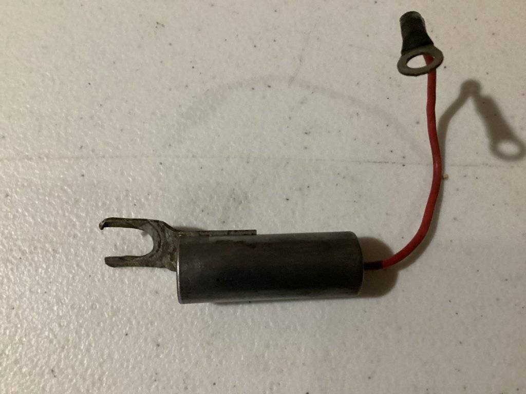

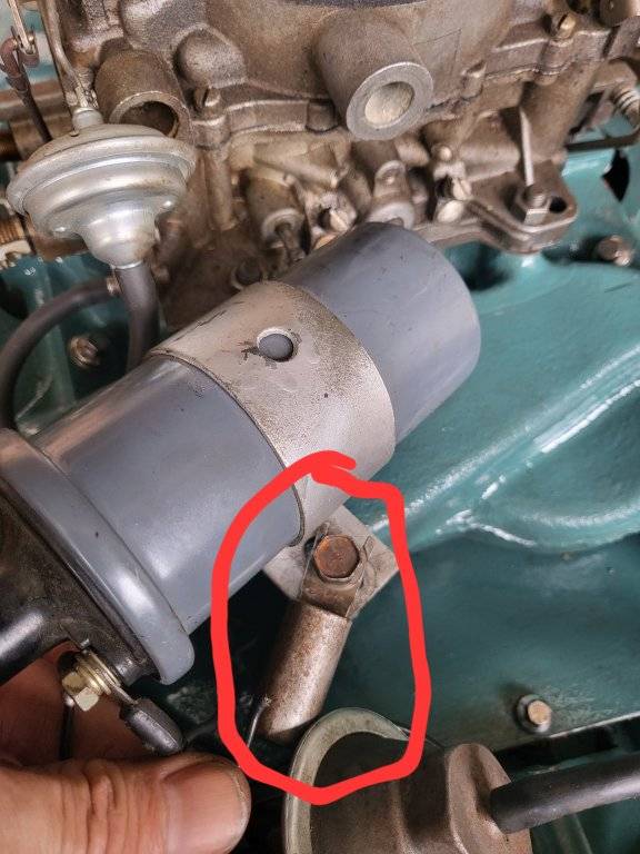

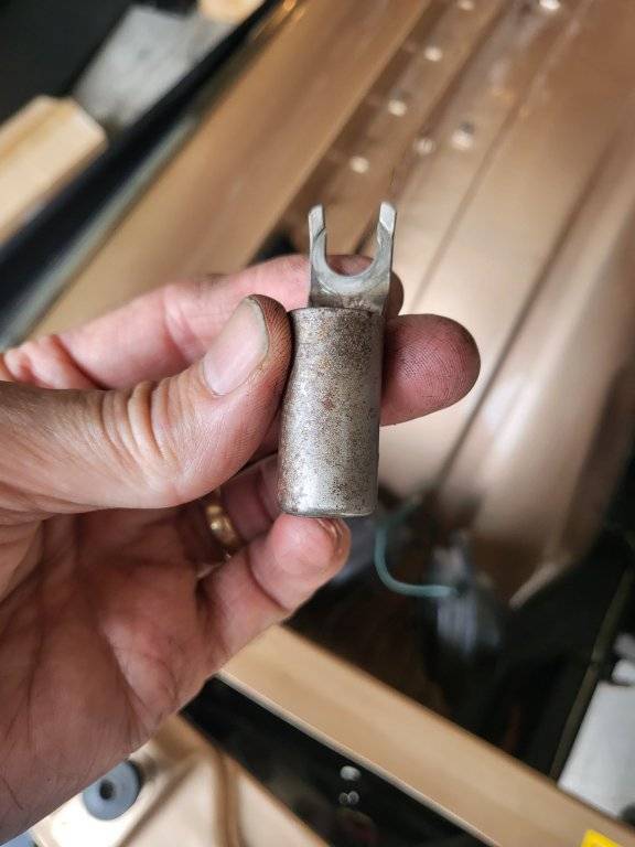

Don't exactly know what it is called but I broke the leading right at the base. It is mounted to the intake manifold and wired to the coil. I would be open to a new universal one if anyone has a suggestion. I did find one on ebay but there is no way I am paying $87 for it. Thanks

Mine did the exact same thing, lead broke off at the case of the condenser (capacitor). Never replaced it because I could never find one to match.
If you don't listen to AM radio you really won't need it, if that's any consolation. It is there to help cancel noise spikes in the +12 volt system that are generated by the ignition coil. These noise spikes can be picked up in the AM band but are not a factor in the FM band.
Thanks I have converted my original AM radio so I never listen to the AM anymore. I was wondering if there would be any noise on the FM channels. I am still working on putting her back together from pulling the heads.

Motorola use to make a kit for all three suppressors. Can find them on ebay from time to time. That capacitor is .25mfd at 400 volts (for the big spikes) if memory is right.
