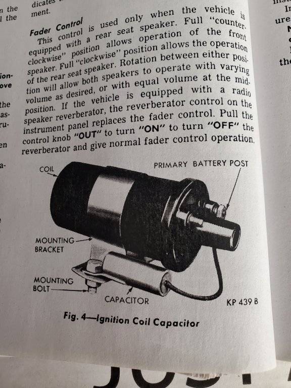

Hello Everyone,
I haven't posted in a bit but I hope you are all well! Got Ethel out a could weeks ago even though we still have some chilly nights. I had my new upper ball joints and control arm bushings installed along with a new steering box with tighter ratio from firm feel and an alignment, next will we my squad wheels with new tires! Anyway shortly after I got the vehicle back from the shop my radio signal has gone to crap and is mostly staticits nothing the shop did but I am thinking it is the ignition coil capacitor causing the issue. I had my dizzy rebuilt last year and curved and had a new coil sent along with it. Anyway I have attached a photo from the service manual and I'm wondering where I can find one of these things. I'm pretty sure the capacitor that is on there is the original. Thank you in advance

Coil capacitor it is for sure, AM only. I have some universal ones and a few NOS but need a part number for the one you have should be on the back.
Awesome, I will look for the part number it may be a little tough to see, ill have it for you today hopefully, donyou need the specs for the coil as well?

I am, and I like the oldies station which no longer comes in but hopefully that is the fix part number is 2197674 there is another number below and that is 6445

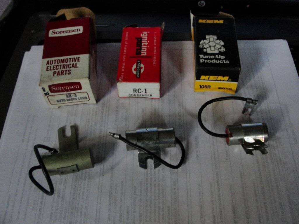

All I have is a later NOS mopar one same style will work and these NORS replacements.
If you want one PM me
