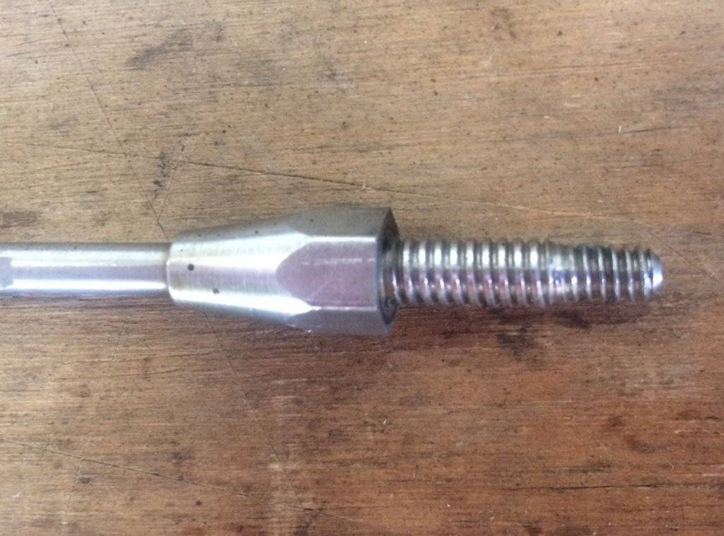

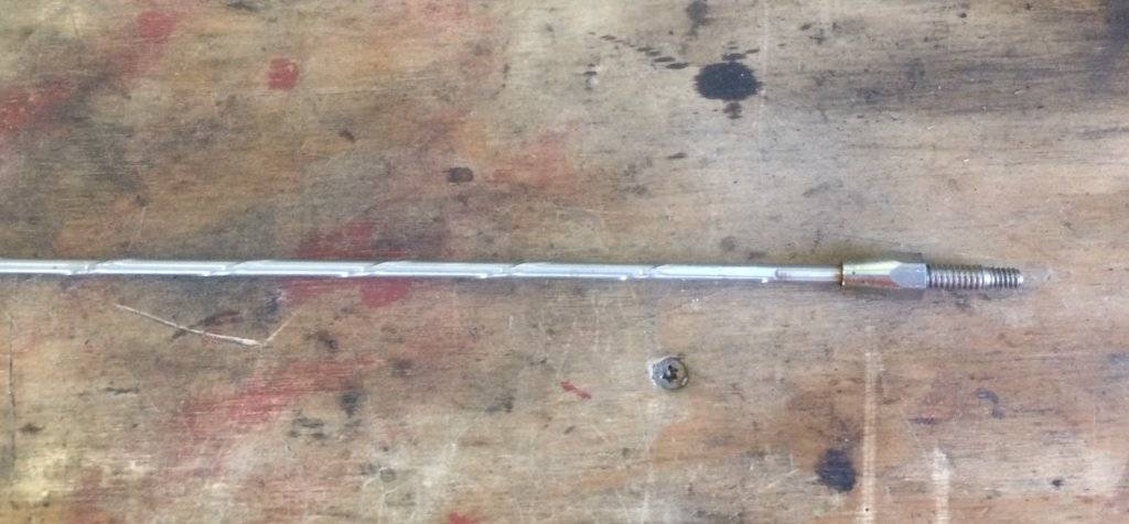

I did though use a 31 inch antenna from a fender I bought for my Dakota, was able to spin a 1/4-20 thread on a shoulder above the metric thread.
This work better than telescoping model that came with antenna. Anyone ever try those hidden antennas or signal boosters I see on Ebay?
