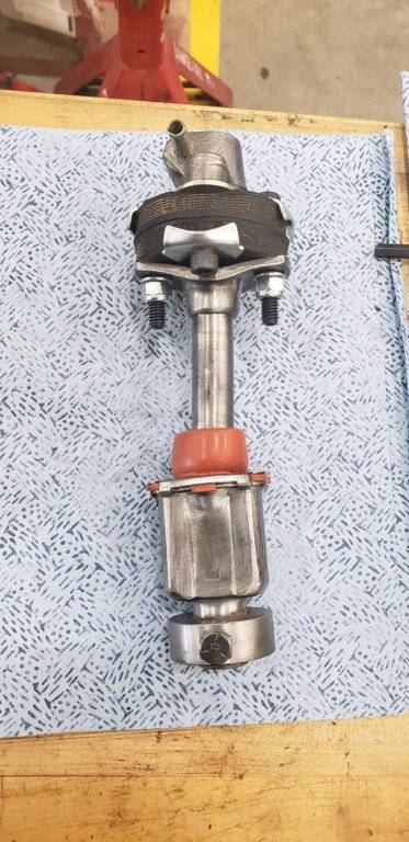

    Thanks everyone for the help. I found a dorman replacement part that worked perfect and with no modification. So, I rebuilt it myself. Here is the outcome....

    Way to go
    What is the part #?

    Dorman #31002

    Don't forget to make sure that you have a good ground across the joint, or you will not have a working horn.

    Totally forgot about that....THANKS!!!!!
