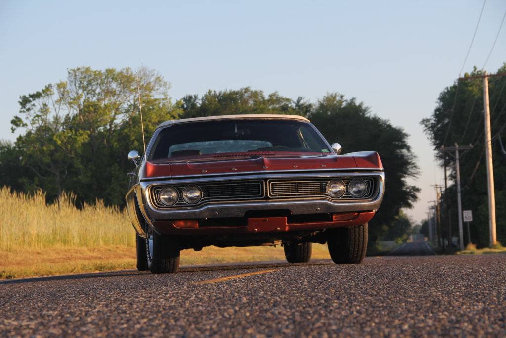

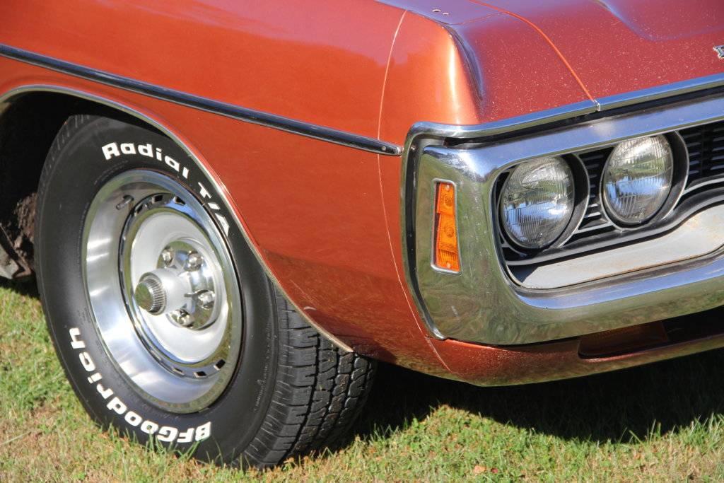

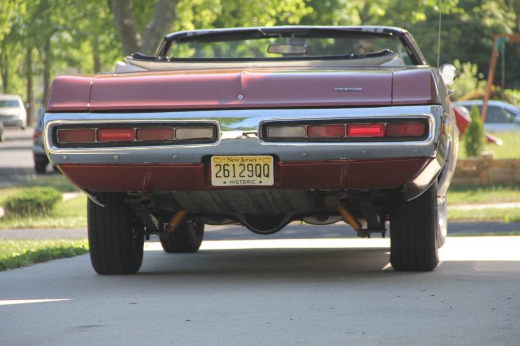

    This should be enough
    193510 2017 Watkins Glen 2.JPG 193510 2015 5-24 (4).JPG 193510 2015 5-24 (3).JPG 193510 2014 oct 21.JPG

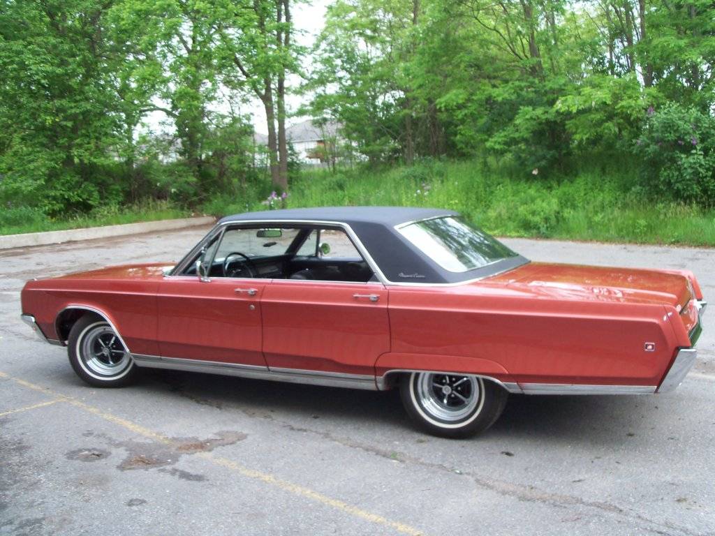

    I am running 23570R15 GT Radial Max Touring radial 50 Summit 15X7 Magnum 500's

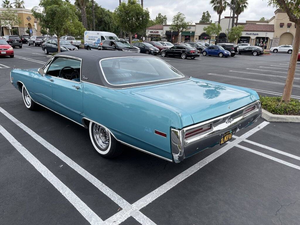

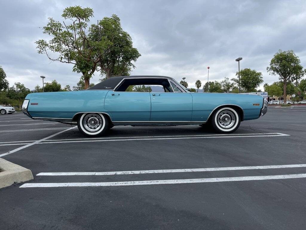

    I know this is an old post but I just did exactly this, Rallye wheels 15x7 4 1/4 backspacing on 235/75/15 tires all the way around. Fits great no issues IMG_3259.jpg IMG_3257.jpg and I have disc up front and drums on the rear.
