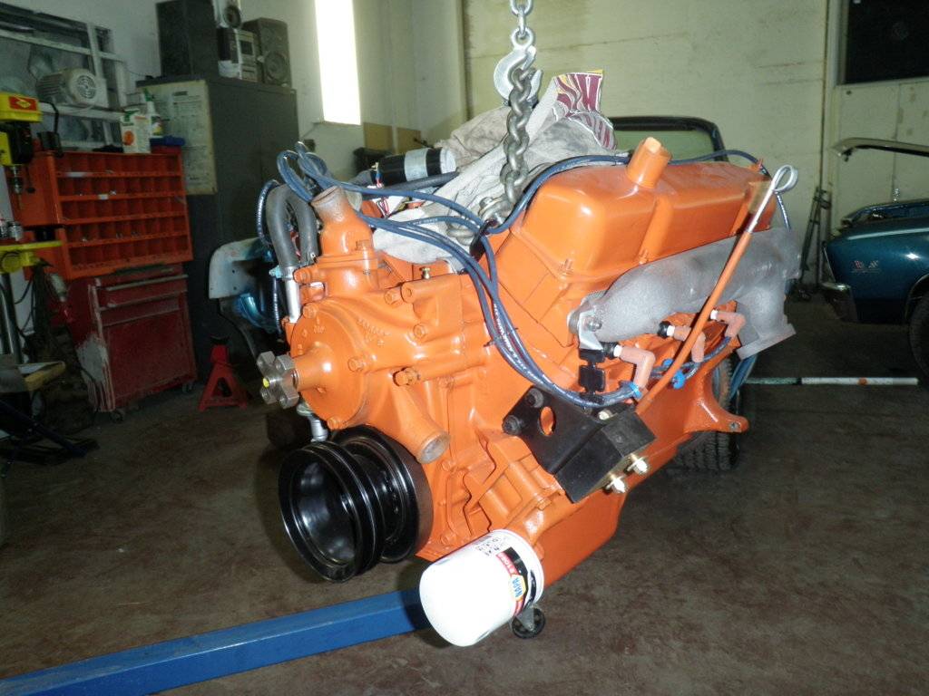

    Check to see if the mount can be fastened as in this picture...

    '64 was the last model year a 361 was in a Newport. '65 had either a 383 B or 413 RB. '66 was 383 or 440. FWIW. Were Canadian models different in that respect?
    Interesting picture!

    Are you referring to my 413?
