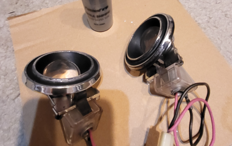

I wanted to rehabilitate the chrome on the plastic of some of my interior pieces. I used this stuff:
Amazon.com
Not quite as good of a finish as plastic that has vapor deposited metal, but pretty darn good. Way better than I thought would be possible with paint. Compare the outer ring of these reading lamps. The one on the right I had not yet painted and you can see how worn off the original chrome is.
The key I found is to put it on pretty wet so that it flows out before drying, but not so wet that it runs. It takes a steady hand though and that's something I definitely struggle with.

This is what I have to try to duplicate. The outside is chrome with the inside being silver, kind of aluminum looking. The blank piece was my trial piece for some Duplicolor chrome... Which kind of failed miserably, but the center silver is spot on.
The blank is soaking in brake fluid right now to remove the paint so I can start over.
