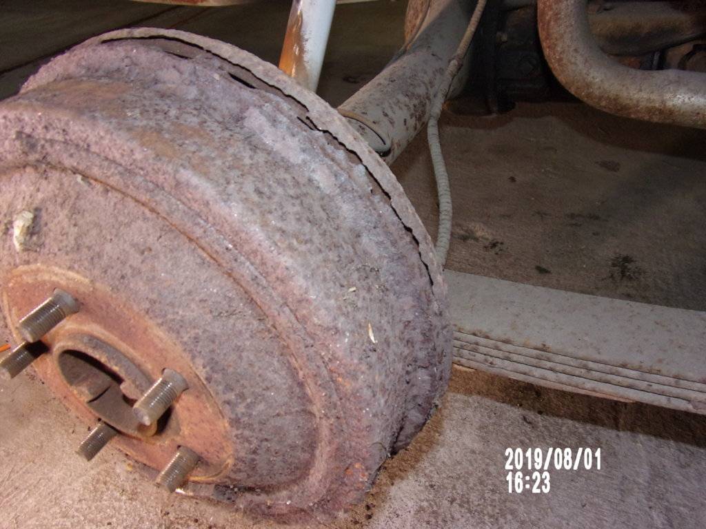

I was thinking of re-using these rear brake drums....NOT! It's amazing that the car actually would stop, not at any speed of course. So now I'm doing a complete brake overhaul again, the second one in the last 4 months. I will have questions, so stay tuned.... Rich

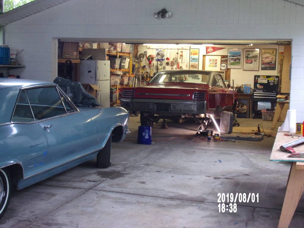

The car was a street find up in Columbus last month. Owner was moving, car had a bad ammeter and wouldn't start. I was at the right place at the right time. C-body forum helped e diagnose the electrical issues. I had it shipped here to Tampa, which cost 800, so the buy-in was just $2050. Now she runs great, but the brakes are a fright as you can see. Almost the same story with the '63 Riviera, except the Riv cost me 6K.
Have the machine shop MIC the drums, if they can safely be turned, go ahead and use them as even a little rusty they are probably still better than the ChiCom replacements. If the inner radius of the drum(s) next to the backing plates show severe erosion with gaps along the outer edge, the drums will need to be replaced. The backing plates are severely rusted and should be replaced. This car has seen salt so check all the steel brake lines carefully. Car looks nice otherwise. Note the rear axle brake line is improperly routed.

I have new drums, from Advance Auto Parts actually. I was joking of course about re-using the old drums, the back rim is all but rusted off.
