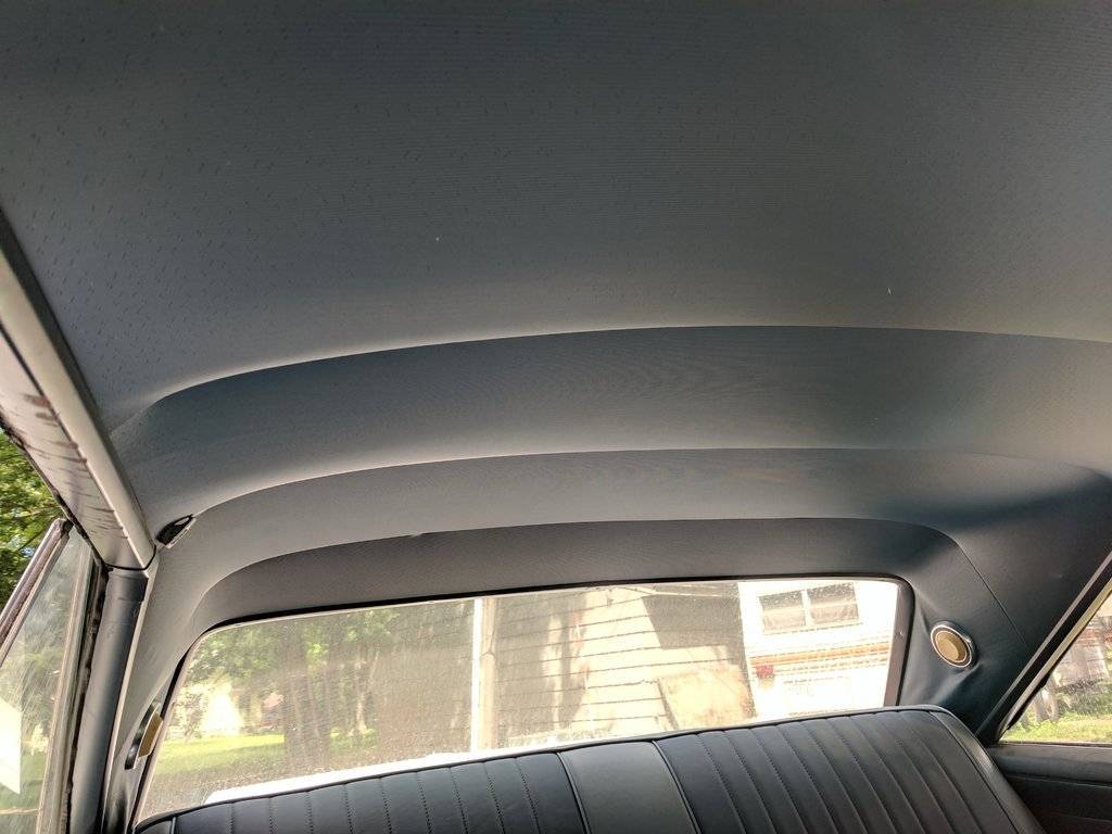

So I have a great headliner out of Project Sidetrack 2, and I'd love to use it in my Polara. I'm wondering if anyone has done this before and what tips they might have to help me among the way. I realize patience will be my greatest all. I have the FSM so I know the steps to follow. I'm assuming the factory used a piece with extra material that I will not have. I've taken as many pictures to help me remember what I did. I worked from the rear forward when taking it out.
Whatever tips or techniques you can share would be helpful. Or if I'm just gonna have a hell of a time getting it right, or it won't work at all, chime in and say so.
Just wanna say be careful. Real easy to pull the seams apart, most of those fail for that reason. However, if I can sew up a new one using the old one as a pattern and install it successfully then you should be able to reuse one.
You added extra around the edges, right?
And yeah, I was careful, this one feels really nice though, better than most I've come across.
No, I wasn't that smart - I cut the new to match what came out.
Ok, that makes me feel better. Just take my time, follow the FSM (simple and straightforward) and enjoy it when it's done.
I still have to take the old headliner out of the Polara, so I'll get another chance to look at how it's on, in case I missed something on Sidetrack 2. I've wanted a better headliner for over a decade, I can wait a few more days (weeks).
