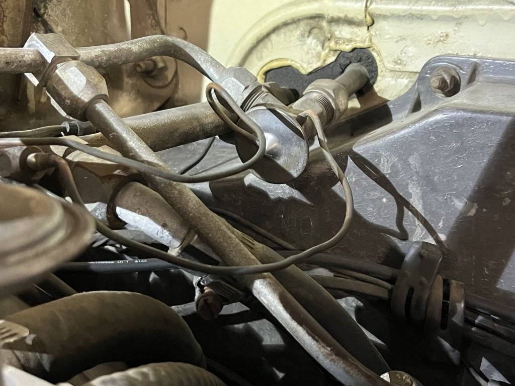

In my 66 T&C with factory Rear AC, the rear circuit's freon lines are connected directly to the front circuit's freon lines by splitters near the firewall. The blower fan for the Rear AC are independently controlled by a switch on the dash, and can be on or off whether the front HVAC system's fans is on or not.
This means that the freon is always circulating through both systems when the compressor is engaged, regardless as to whether or not the blower fan is on or not for the Rear AC.

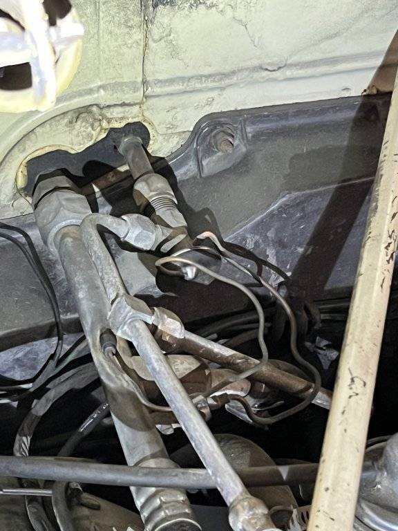

If you can show pictures of your system's installation, and include some pics of the dashboard controls, it would help.
It is very likely a factory assembly line install, and if the Rear AC blower comes on with the front blower, it's an "always on" dual system. However, I would believe it should have been a dash mounted "Rear Air" fan switch, and that perhaps it crapped out and someone connected it to the HVAC switch.

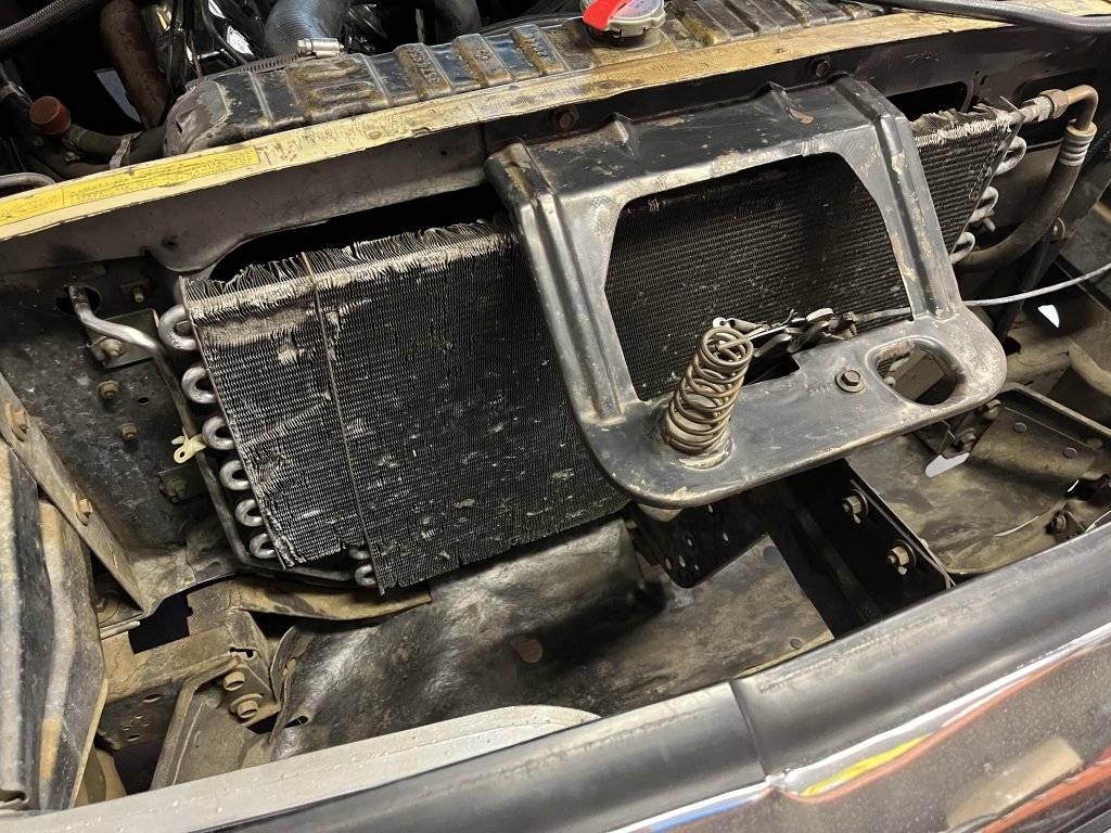

Here are a couple of photos for reference. The front condensor has seen better days, but is may still work. The heater core works very well without leaking, so we are 80% confirdant the the A/C portion under the dash is still good as well. The dryer will be replaced with a standard R-12 component.

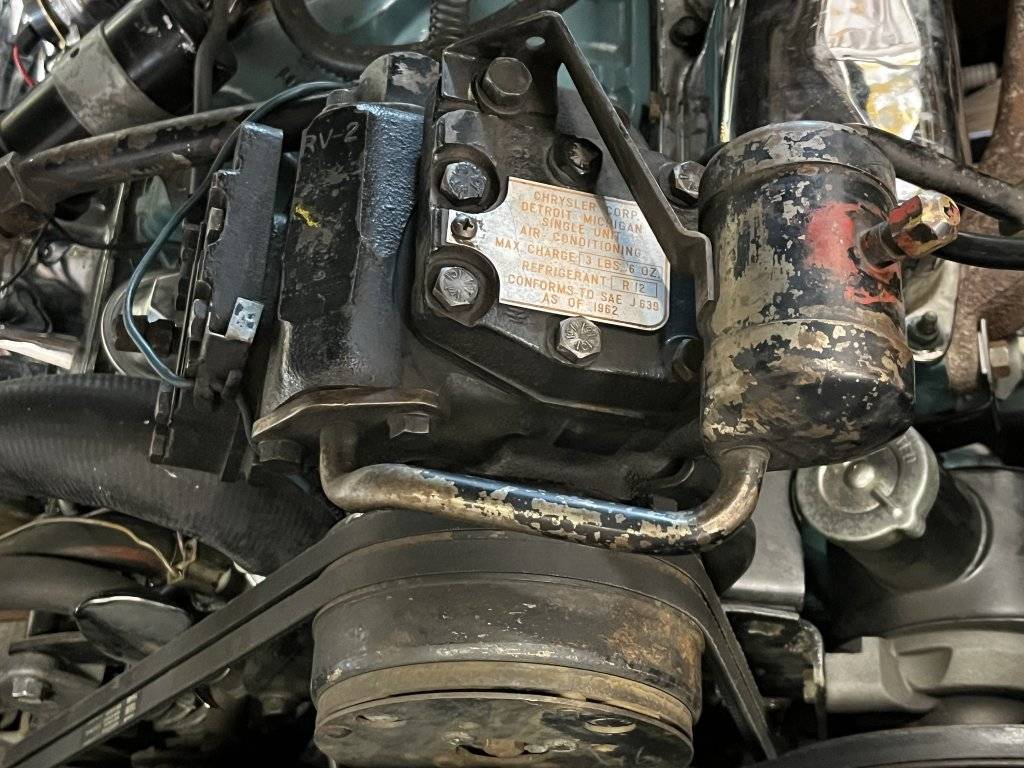

You said: "The blue colored wire from the time delay to the compressor is missing, so I have to fabricate that and determine if the clutch is still operational on the compressor. I did not want to run the compressor on an empty system."
It's easy to test the clutch, but if there's no freon or compressor oil in the system, only do it for a very sort time - with the engine running, put 12V directly to the wire going to the compressor - you can see it clipped to the compressor body, so just find its connector and apply 12V there. If the front plate on the clutch starts turning, the compressor clutch works.

This looks to be a stock installation of the rear seat air as these fittings are all factory.
