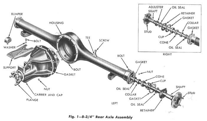

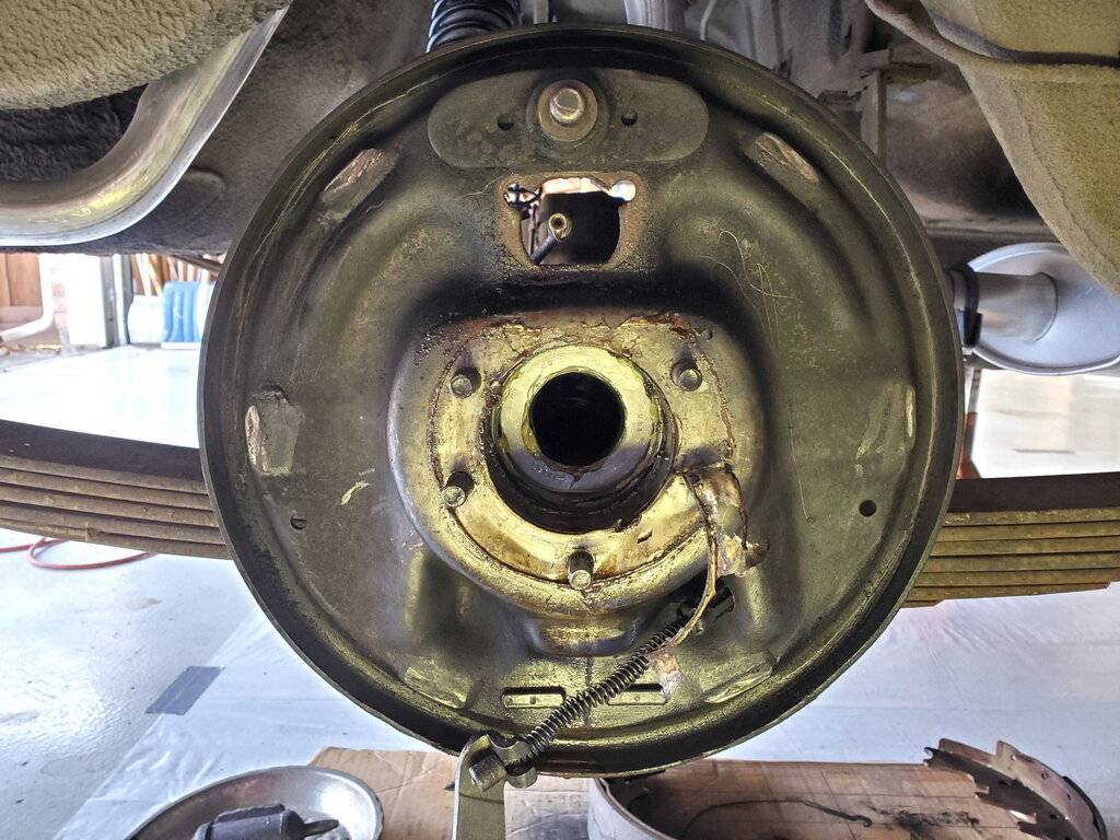

Making more progress, removed the old inner seals today and cleaned the axles and bearings with Brakleen. I've ordered new backing plate gaskets and seals. I love the picture in the FSM showing removing the seal with a slide hammer puller, like it will just pop out. Like every other axle seal I've done I needed a hacksaw blade, chisel, screwdriver and hammer to get them out! I also cleaned up the backing plates, it is obvious that there have been many leaks for a long time...

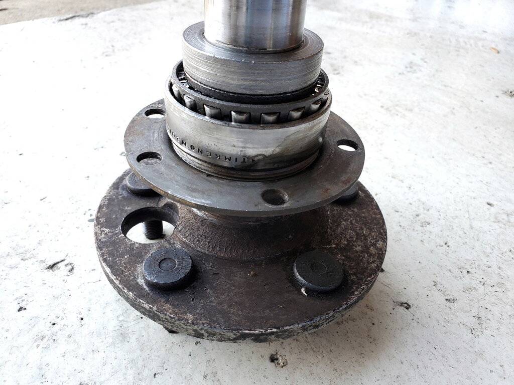

Slide hammer works. Drill a small hole in the metal part of the seal, seat a sheet metal screw in the seal with the collar for the slide hammer attached, screw the collar onto the slide hammer and let the slide hammer do its work. This method avoids putting any grooves or other damage to the capture point for the seal. Check the axle in the photo carefully, it looks to have a cut just above the bearing retainer, this is a potential fracture point. The retaining collar also has some groove marks from riding on the housing, this usually happens when a failed bearing gives way. Failed bearing likely also caused the cut to the axle from the metal part of the seal contacting the axle. The cut in the axle is also the probable cause of the oil leak as the seal can not stop oil from getting past the cut do to the lack of a good bonding surface.

Inner seal, lip faces in toward differential, keeps the oil in center and out of grease on the bearing.
