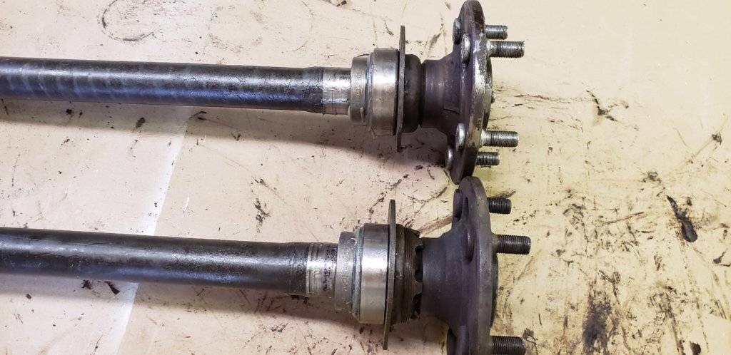

After watching the video I decided to take a shot at removing the bearings. It went pretty well, got my second one off in about half the time. I was being extremely cautious on the first one.

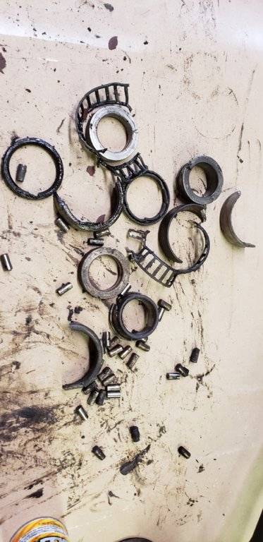

The right side was really bad completely dried out, the left wasn't as bad, but there was play in the bearing.
Here is my pile of bearings.

Your bearing pile looks worse than mine were, but just a bit. I cut the old ones off w a grinder and GASP! nicked the journal when I slipped. THANK GOD, it was far enough back that I was able to cover the scratch entirely with a second seal, right behind the first. I've not lost a drop of oil since then, over 19 months ago, so I count my blessings.

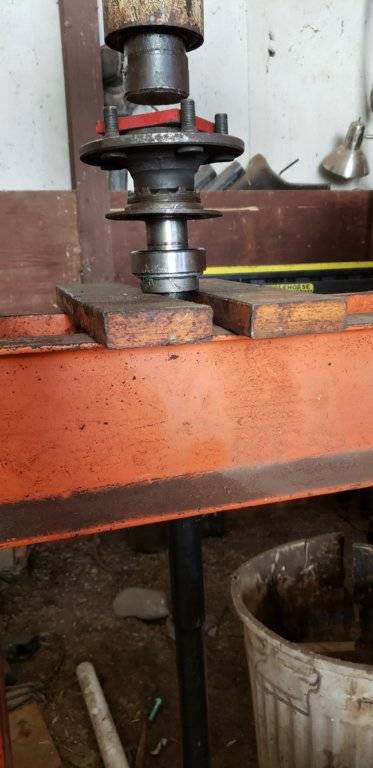

Ok I don't want to screw this up. I have access to a 20 ton so I pressed on the bearings no problem. I installed the axel shafts and followed the direction for end play for the service manual.
The right side has the adjuster got it perfect, went to the left and it is very sloppy moves .10 of an inch as opposed to the .013-.023 they recommend on the right side. Have I simply not press the bearing on too far? I have this same movement between the flange and the bearing when I have it off the car.
I started to get more resistance on the press and didn't want to press it on too far. Should I just put it back on the press until the bearing is just within that tolerance to the flange?

I am not certain, will have to look. I drove the bearings basically where it was. I presumed there was supposed to be some movement, now I wondered if the original bearing moved out from the factory location.
