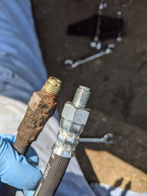

    The male part of the new hose I bought is skinnier and longer than the original. The new will not screw into the T.
    It appears the new hose is the 14.5 inch version. The original hose is the 13.94 version. Do the shorter length hoses come with the shorter fatter male end that goes into the T?

    I had the same problem with getting a replacement rear hose for my 68 fury. Seems when I told them 4 wheel drum it was a different diameter on the male threaded end than my original. So they looked up front disc, and rear drum and it was correct.

    Josh / Furyus67,
    If you haven't solved the problem -- call me. It is simple. From your picture, it looks like some idiot gave you a 3/8" male hose instead of 7/16". (Probably had no clue what he did wrong -- and doesn't know what those sizes are or mean !!!!)

    I ordered one from napa, they have to get it from the next store over so it won't be here until tomorrow. I'll take the old one in to compare.
