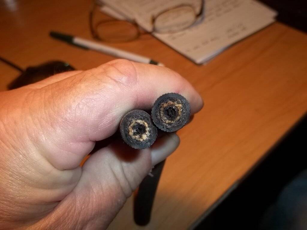

I couldn't get my rear brakes to bleed.
Fluid would just dribble out.
Replaced the rear brake line. Couldn't blow air through it so I cut it open....
