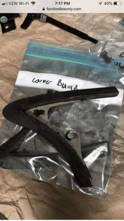

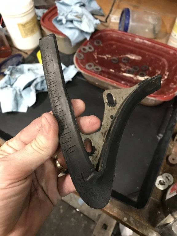

    F447E19E-40CD-493B-A765-96C15ABE15DC.jpeg E724C1F4-EC63-45E3-B9B2-567CE3698F79.jpeg What’s the best way to repair these rear bumper guards? 1970 Fury Convertible. Thanks!

    For my front bumper inserts on my '68 Polara, I couldn't find any NOS or replacements. I ended up buying the spray Plasiti-dip. I would spray a couple of coats, let it cure and settle into the cracks, then sand. Repeat, Repeat, Repeat until most of the cracks are gone. Mine have been in place a year now. So far so good. I will see if I can find the link or pictures.

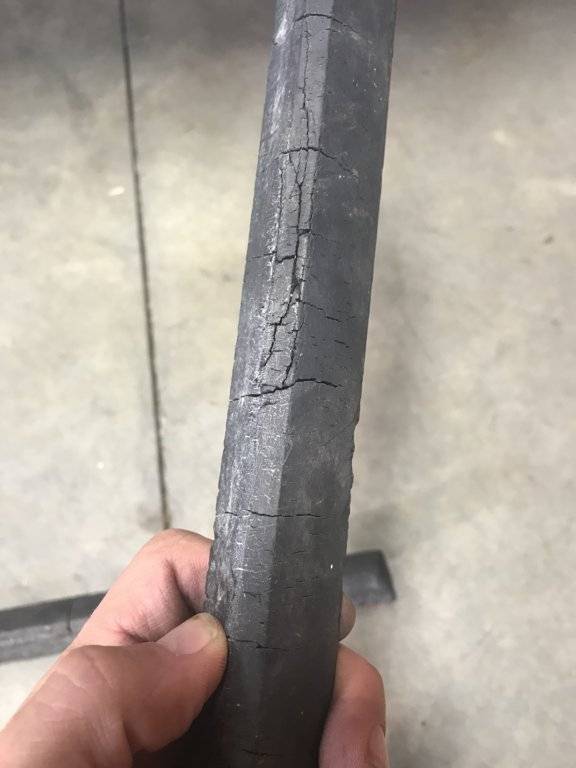

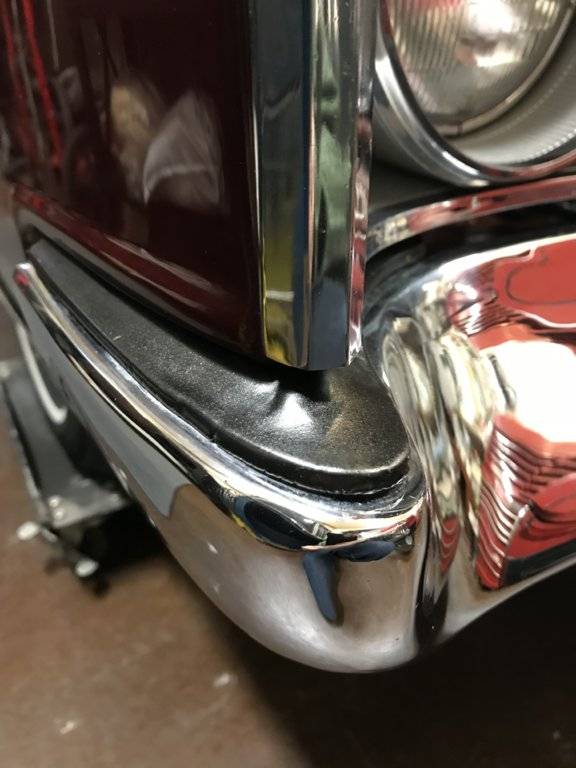

    Here is the final product after plasti-dip spray and sanding. repeat ... And before at the bottom. (Proof I posted it in a thread somewhere) Not perfect but much better.
    Soaked a couple of days in ammonia, supposedly it is supposed to bring the oils in the rubber back out to soften it up.

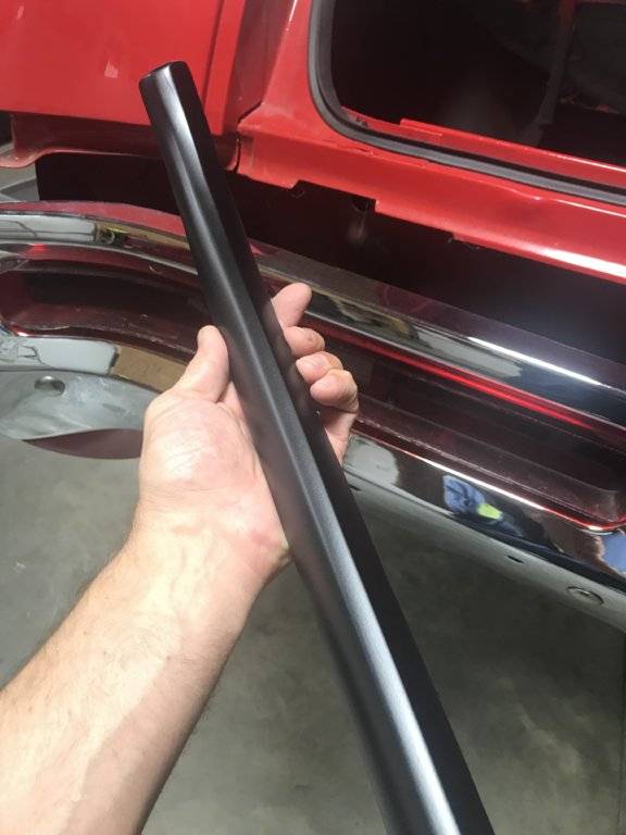

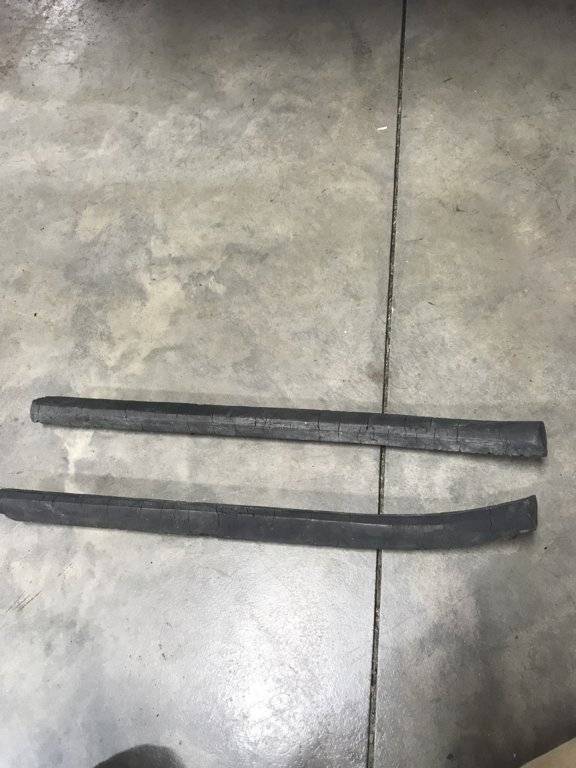

    DA5895E2-BE96-4444-BC25-360150CFB659.jpeg Here’s the finished product. I’ll take more pics when installed on the bumper. So far I’m pleased.
