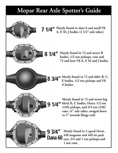

Looks like I need a new speedometer gear, my speedometer is off 5- 10 mph. I have a '65 Newport. Convertible 383 2bbl. Any ideas what rear end it has? Figured I'd ask the experts. Thanks!
detmatt
Nov 14, 2010
26,472
23,288
8 3/4”.
What ratio? None of us would be able to tell you that for sure.
The best way to tell for sure is to safely Jack up the rear and see how many revolutions the driveshaft spins for every 1 full rotation of the tire.

what size tires are on it ? if the 14"s have been swapped for 15"s that could be the issue
68 4spd Fury
Aug 17, 2014
1,087
708
Syracuse, NY
I assume automatic trans? Standard off the line would be 2.76:1 unless it was ordered special. However, in 50+ years you never know what was swapped out. As stated, check tire size, jack up and count the rotations. Might also be a tag on the diff, if it survived, that has it on there.

Might as well provide brand and tire dimensions in full ie 235/70/15 etc while you’re at it and verify rear end type, most likely 8 3/4 but take a look to verify.

Pretty sure 8 3/4
A little help to verify your axle
