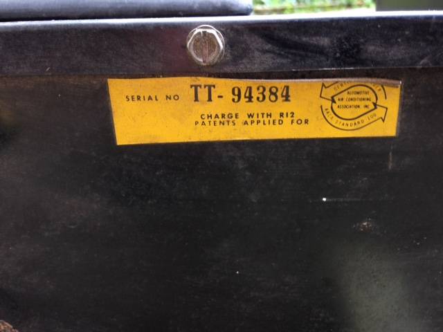

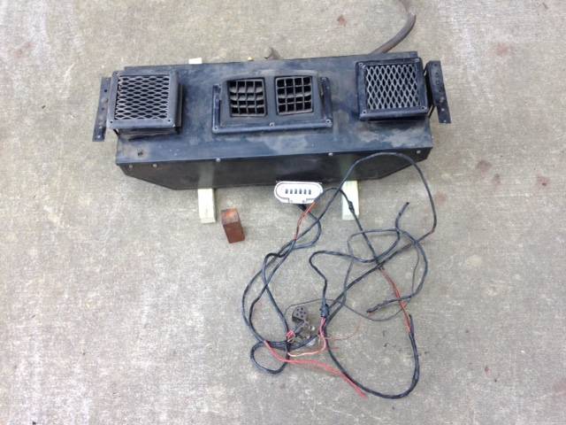

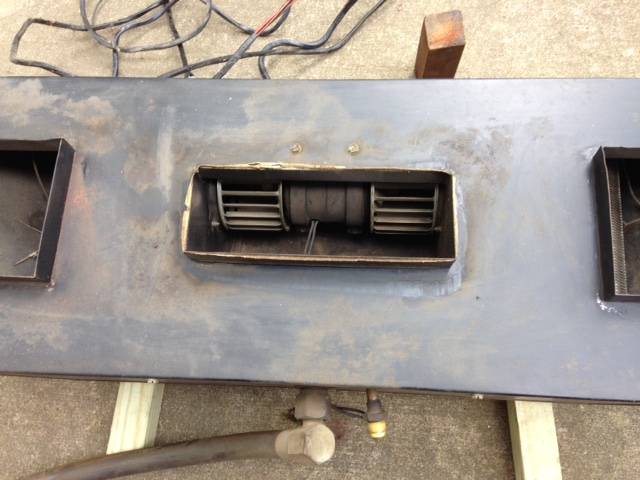

In the early '70's I owned a '68 New Yorker that had heat and ac for the back seat. A few years ago I purchased a '66 Plymouth Satellite that had dealer installed rear heat/ac. It was mounted to the package tray. Does anyone know if this could be the same system used in the New Yorker? Here are some pictures of it. I don't plan to put it back in the Plymouth so I will sell it if anyone is interested.
Kinda looks after market to me. I had a '67 Imperial and a '73 Imperial with factory rear air. Looked nothing like that. Not saying it won't work but I'm pretty sure it's not factory.
I suspect that if it had been a factory option, it would not have had the "Clutch ON/OFF" buttons as the EPR valve would have been in place to keep the core from freezing up. Probably should have been some Pentastar imprints/stamps somewhere on the item (especially the serial number tag) if it had anything to do with Chrysler AirTemp, back then.

I found the owner information book for the unit. It is a Mark IV trunk air conditioning system. It has a clutch ON/OFF button. It is air conditioning only. The two fittings that I thought were for water are just condensate drain holes. The car had factory air conditioning. The trunk air conditioning was installed by the dealer.
