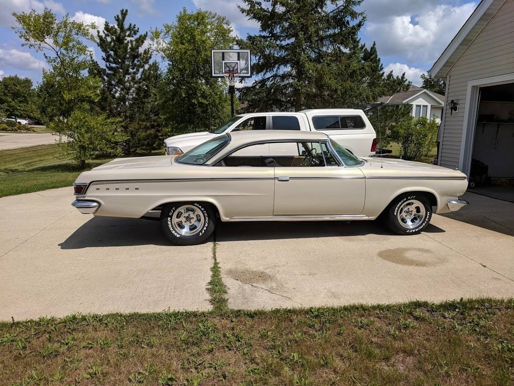

This is my ride height with HDs.

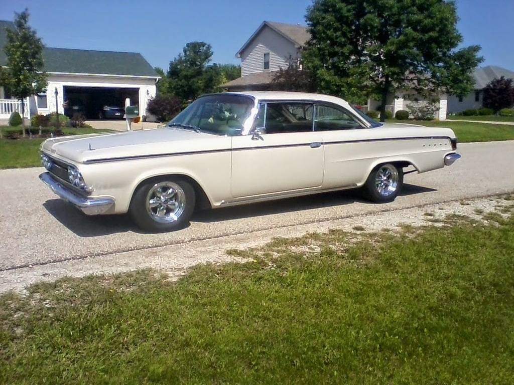

This is with old springs.

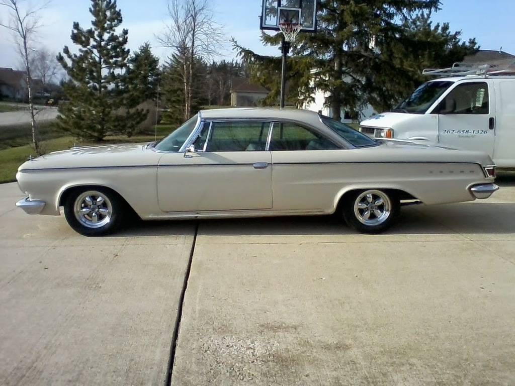

I got mine from a local shop when I was in Chicago, it does sit a little higher in the back. But it gives it a nice rake! Good Luck

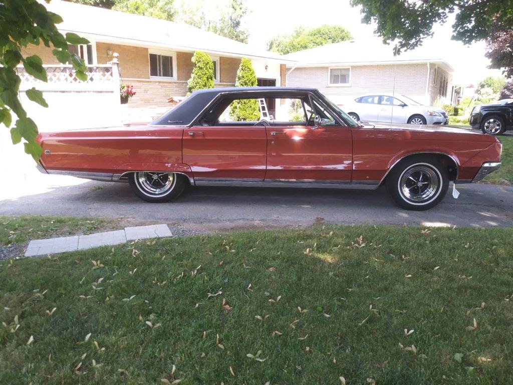

I do travel and the trunk is usually loaded
How's the ride with the HD springs vs stock?
Definitely much stiffer, I only have about 1000 miles on them so I am hoping they loosing up a bit. I like the look of the rake and that is what I was after. Future plans do include a hitch for a small pop up, but we shall see.

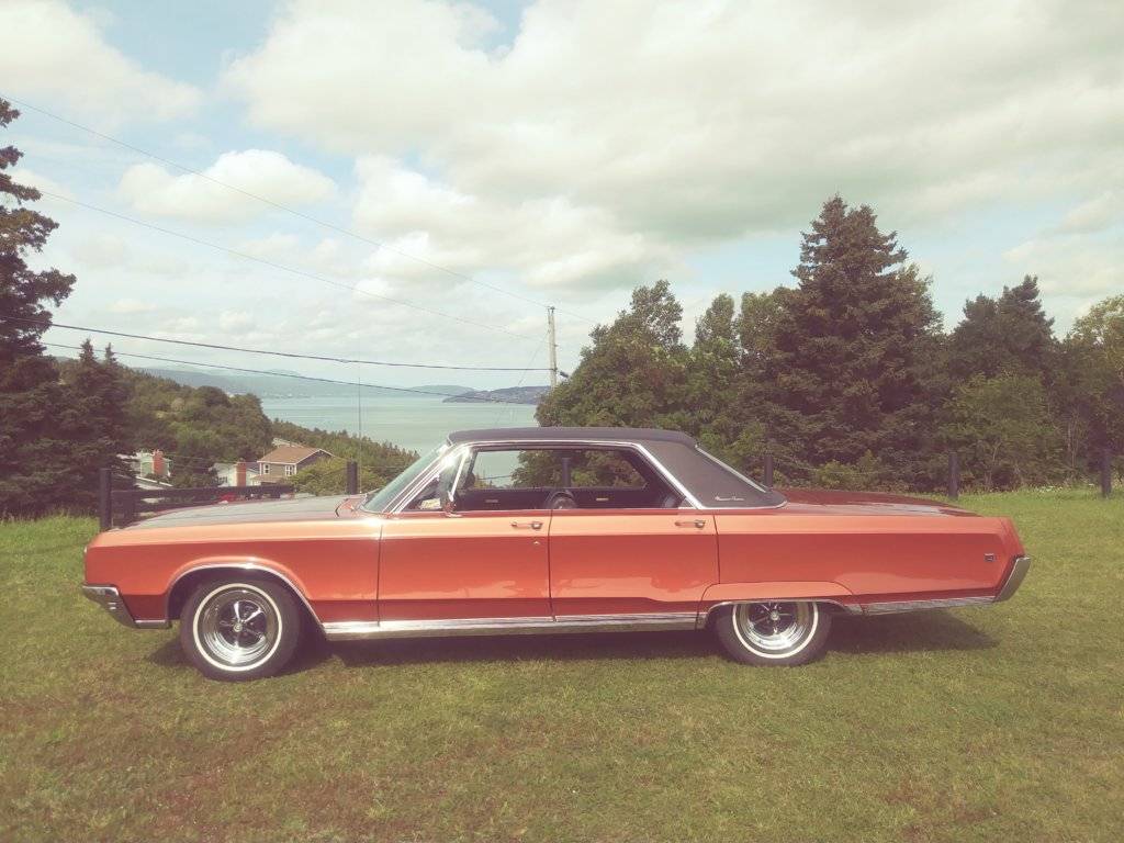

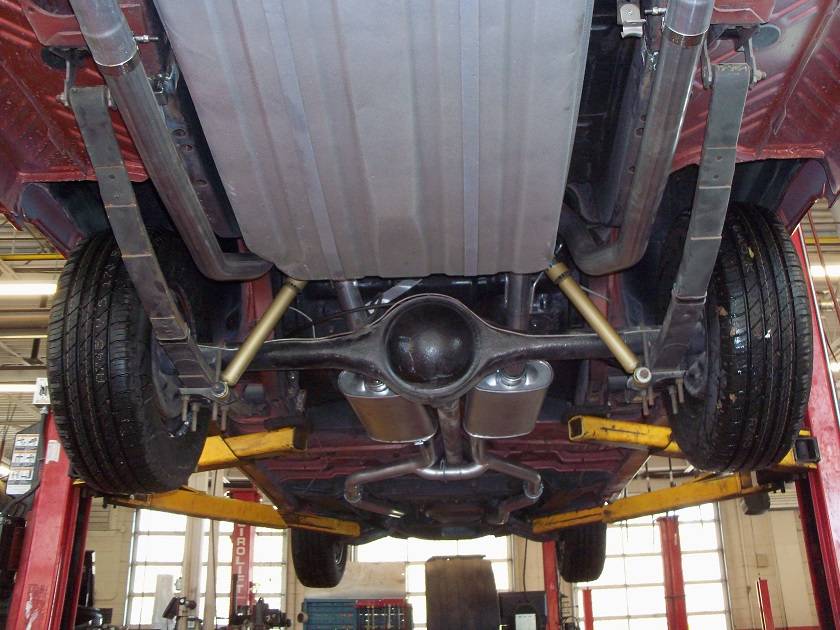

7 leafs...B body rear shackles..Fully loaded for bear..
And when empty...
Rides smooth both ways. Never bottomed out even on rough highways of the Maritimes and U.S. Eastern seaboard.
Shocks are NORS AC Delco "Pleasurizers.
